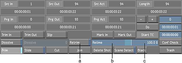

(a) Retrim button (b) Retime slider (c) Retime field
Enable Retrim to trim the shot so that the same source in and out points are used. You can also trim the shot using the tools in the Edit menu.
If you do not enable Retrim, the source out point changes shots. This is especially noticeable when you speed up a shot, since you may end up with black frames at the end of the adjusted shot. You can remove the black frames using the trimming tools. See Trimming from the Edit Menu.
Drag the Retime slider to the new playback speed or right-click on the Retime slider to enter a retime value in the Retime field.
