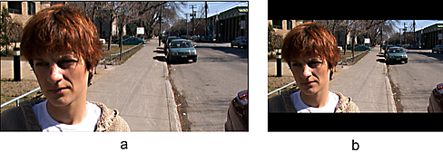

With letterbox images, you are scaling down a widescreen frame to fit horizontally on a television screen. This process adds black bars across the top and bottom of the screen and reduces the size of the images. However, letterboxing has the advantage of showing the entire image, thus remaining true to the vision of the artists.
(a) Original widescreen frame  (b) Letterboxed frame  

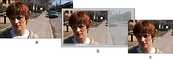

When you reposition frames, the actual source images are larger than the viewable area. To compensate, you make adjustments to the pan and scan of the frames to emphasize the key elements of a scene. For example, if the original frames show two people facing each other and talking, you may pan back and forth to see the person who is talking. The other person would then be partially or even completely off screen.
(a) Original widescreen frame  (b) Cropped and repositioned frame  (c) Final frame  

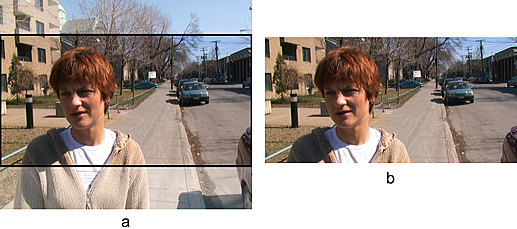

Use racking when you want to deliver your footage in a wider format than it was shot in. For example, when shooting on 35mm film, you may compose the scene so that the important elements of the image are contained in a narrow horizontal portion of the frame. In such a case, you set a cropping gate, and then adjust the vertical position (scan) of the shot in order to compose the scene as needed.
(a) Original 35mm with racking on  (b) Cropped frame  
