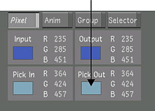

    The sample appears in the Pixel Analyser.
