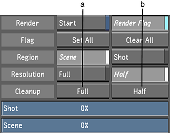

  3. Do one of the following.
    Click: To:
    Cleanup Full and confirm Remove all full-resolution render files associated with the grade.
    Cleanup Half and confirm Remove all half-resolution files associated with the grade.
    (a) Cleanup Full button  (b) Cleanup Half button
