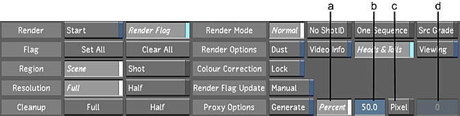

  4. In the Render Local menu, set the proxy size.
    Enable: To enter:
    Percent The size of the proxy as a percentage in the Percent field.
    Pixel The width of the proxy in pixels in the Pixel field.
    (a) Percent button  (b) Percent field  (c) Pixel button  (d) Pixel field  
    Modifying a value in one field automatically updates the value in the other field.
    Note:No other options in the Render Local menu affect generated proxies.
  5. Click Generate.
    The Generate button changes to a Stop button, and proxy generation starts at the first frame of the current shot. It continues through to the end of the cut unless you abort the process by clicking the Stop button.

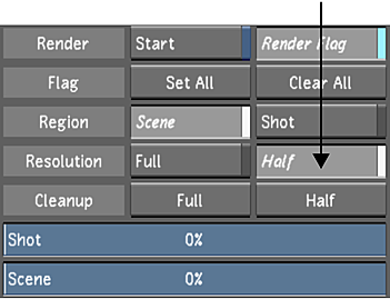

To view proxies:
  1. Do one of the following:
    • Enable the Half Resolution button in the Render Local menu or in the Grade menu.
    • Set the Full/Half Resolution button to 1/2.
    • Press F9.
    Note:An ungenerated proxy appears as a red X with a black background.
