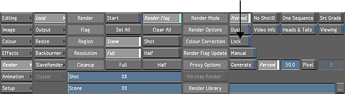

You can lock the colour grading on the current shot so that no colour changes can be made to the shot. This is useful to avoid accidental modification once the grading is complete. For example, you might want to lock the colour grading after it has received final client approval.
To lock colour grading:
Navigate to the shot for which you want to lock the colour grading.
Do one of the following:
The word “Locked” appears in the Printer Light fields and the shot can no longer be modified in any of the Colour menus until either the Lock button or Lock flag has been disabled.
