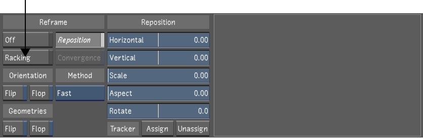

Racking involves adjusting the vertical position of a shot. You need to rack your images after you adjust the aspect ratio. By racking, you ensure that the important element of the shot composition is framed correctly in the final images.
To adjust the racking of an image:
  1. Display the Reposition menu. See Accessing the Reposition Menu.
  2. Enable Racking.
  3. Use the Vertical slider to adjust the vertical position of the image.
  4. You can animate the vertical position using the Animation controls. See Animating Reposition Values.
