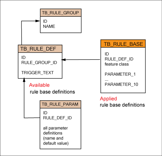

The system tables TB_RULE* store the feature rules.
Table |
Description |
TB_RULE_PARAM |
Stores feature rule parameters. |
TB_RULE_DEF |
Stores all rule base definitions. See also System Table TB_RULE_DEF. |
TB_RULE_GROUP |
Lists rule base groups. Feature rules can be grouped. |
TB_RULE_FCLASSTYPE |
Specifies which feature rules are applied to a feature class when it is created (L = for line string, P = for point, T = for label feature classes). If F_CLASS_TYPE is empty, the rule is assigned to all feature classes. |
TB_RULE_BASE |
Stores the configuration of individual rules for each feature class (applied rule base definitions).
Note:
Only rules that are listed here can be activated. |
TB_TMP_FEATURE TB_TMP_FEATURE_TBL |
Stores temporary data for server-side feature rules and topology or compound feature classes. |
