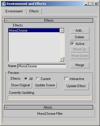

rollout about_rollout "About..."
label about_label "MonoChrome Filter"
The plug-in will have no controls. We will create a very simple rollout containing a single line of text just to show the user he has loaded something.

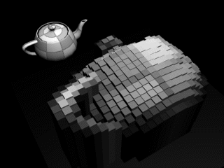

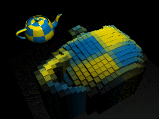

After evaluating the script, a new plug-in effect called "MonoChrome" will appear on the Renderer > Effects... > Add... list. Add it to the effects queue and render the scene. The result will be a monochrome version of the rendering. Note that scripted renderEffects are relatively slow compared to "real" plug-ins written with the SDK, but are very flexible and fast to prototype.
In the Virtual Frame Buffer, you can take a look at the Alpha and Monochrome version of the image - the Alpha should be unchanged, and the Monochrome version should be identical to the RGB image generated by the renderEffect.
