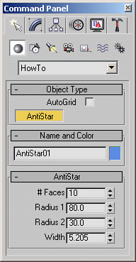

   parameters main rollout:params
   num_faces type:#integer ui:num_faces default:10
   radius1 type:#float ui:radius1 default:0
   radius2 type:#float ui:radius2 default:0
   width type:#float ui:width default:1
   rollout params "AntiStar"
   spinner num_faces "# Faces"range:[2,100,10] type:#integer
   spinner radius1 "Radius 1 "range:[0,10000,0]
   spinner radius2 "Radius 2 "range:[0,10000,0]
   spinner width "Width "range:[0,90,1]
The scripted plug-in stores its parameters in a so-called Parameter Block. The ParamBlock2 format has been introduced in 3ds Max 3 and allows for easy properties and tracks management, automatic animation brackets in the UI, and more. In this case, we will store the same values used in the first mesh script (number of faces, the two radii and the width (offset) value) in the ParamBlock.
All parameters in the block have their counterparts in the plug-ins rollout in the UI. By providing the rollout name, you allow the ParamBlock to establish an automatic connection between the internal values and the UI elements.
Mid Topic ID: Parameter_block2
The num_faces object property controls the number of "rays" in the object, actually the number of faces. It is an integer and corresponds to a spinner in the UI with the same name. The default number of faces are 10.
radius1 type:#float ui:radius1 default:10
The radius1 object property controls the outer radius of the object. It is a floating point value and corresponds to a spinner in the UI with the same name. The default radius on creation is 10. If you create an object using MAXScript by calling the constructor antiStar(), the object uses this value as the default outer radius.
The radius2 object property controls the inner radius of the object. It is a floating point value and corresponds to a spinner in the UI with the same name. The default radius on creation is 0.
The width object property controls the offset of the outer vertices and defines the width of the rays. It is a floating point value and corresponds to a spinner in the UI with the same name. The default width on creation is 1.
spinner num_faces "# Faces" range:[2,100,10] type:#integer
spinner radius1 "Radius 1" range:[0,10000,0]
spinner radius2 "Radius 2" range:[0,10000,0]
spinner width "Width" range:[0,90,1]
Now, you can provide the rollout with UI elements referenced by the Parameter Block. The UI elements can limit the input values using the optional range: parameter, but the default value is taken from the ParamBlock2.

Using the Script
This is a scripted plug-in and it is handled by 3ds Max as a real C++ plug-in.
To install it permanently on your system, copy the file to the \plugins folder or to any other folder listed in the plug-in paths.
To try the plug-in without installing it permanently, evaluate the code and look under Create panel>Geometry>HowTo category in the drop-down list. The plug-in is only available for the single session and will not be there after restarting 3ds Max.
Any MAX files saved with the plug-in in the scene will require the script to be installed and evaluated in order to load correctly.

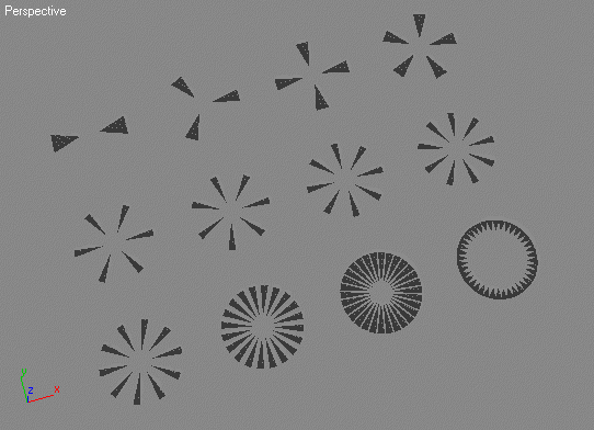

To use the plug-in, click the AntiStar button in the Create panel > Geometry > HowTo. Click in the viewport to define the center, drag to define the outer radius, click and drag again to define the inner radius, and click and drag again to define the width. Click to finish or right-click to cancel.
Play with the controls in the UI under the Modify panel and note how quickly the mesh is updated by the script.
