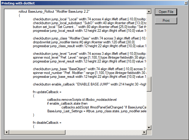

The following tutorials shows the basics of displaying and printing a text file using DotNet.
Related topics:
NATURAL LANGUAGE
Define a MaxForm using the MaxCustomControls assembly containing a text box and two buttons.
Implement a function to print a text file to be called by the Print button's event handler.
Implement a function to open a text file when the event handler of the Open File button is called.
Register the event handlers.
Ensure the event handlers will not be garbage collected.

--Example code provided by Artur Leão ( dotNet.loadAssembly "MaxCustomControls.dll" local filetoprint = "" local printFont = dotnetobject "System.Drawing.Font" "Arial" 10 local streamReader hForm = dotNetObject "MaxCustomControls.MaxForm" hForm.Size = dotNetObject "System.Drawing.Size" 640 480 hForm.FormBorderStyle = (dotnetclass "System.Windows.Forms.FormBorderStyle").FixedToolWindow hForm.Text = "Printing with dotNet" hForm.ShowInTaskbar = False txtTextBox = dotNetObject "System.Windows.Forms.TextBox" txtTextBox.MultiLine = True txtTextBox.WordWrap = False txtTextBox.Size = dotNetObject "System.Drawing.Size" 500 430 txtTextBox.Location = dotNetObject "System.Drawing.Point" 10 10 txtTextBox.ScrollBars = txtTextBox.ScrollBars.Both btnOpenFile = dotNetObject "System.Windows.Forms.Button" btnOpenFile.Location = dotNetObject "System.Drawing.Point" 520 10 btnOpenFile.Text = "Open File" btnPrint = dotNetObject "System.Windows.Forms.Button" btnPrint.Location = dotNetObject "System.Drawing.Point" 520 40 btnPrint.Text = "Print" frmOpenFileDialog = dotNetObject "System.Windows.Forms.OpenFileDialog" frmOpenFileDialog.Filter = "txt files (*.txt)|*.txt|Script Files (*.ms)|*.ms|ini files (*.ini)|*.ini|XML files (*.xml)|*.xml|All files (*.*)|*.*" fn btnOpenFile_Click = ( dlgResult = dotNetClass "System.Windows.Forms.DialogResult" if frmOpenFileDialog.ShowDialog() == dlgResult.OK do ( IOFile = dotNetClass "System.IO.File" txtTextBox.Text = IOFile.ReadAllText frmOpenFileDialog.Filename filetoprint = frmOpenFileDialog.Filename )--end if )--end fn fn pd_PrintPage sender ev = ( count = 0 linesperpage = ev.MarginBounds.Height / printFont.GetHeight(ev.Graphics) yPos = 0 leftMargin = ev.MarginBounds.Left topMargin = ev.MarginBounds.Top currentline = "" brush = dotnetobject "System.Drawing.Solidbrush" (dotnetclass "System.Drawing.Color").black stringformat = dotnetobject "System.Drawing.StringFormat" while count < linesperpage do( currentline = streamReader.ReadLine() if currentline == undefined do exit yPos = topMargin + count * printFont.GetHeight(ev.Graphics) ev.Graphics.DrawString currentline printFont brush leftMargin yPos stringformat count += 1 )--end while loop if currentline != undefined then ev.HasMorePages = true else ev.HasMorePages = false )--end fn fn btnPrint_Click = ( if filetoprint != "" then ( try ( streamReader = dotnetobject "System.IO.Streamreader" filetoprint pd = dotnetobject "System.Drawing.Printing.PrintDocument" dotnet.addeventhandler pd "PrintPage" pd_PrintPage pd.Print() streamReader.Close() )catch print (getCurrentException()) )--end if )--end fn dotNet.AddEventHandler btnOpenFile "Click" btnOpenFile_Click dotNet.AddEventHandler btnPrint "Click" btnPrint_Click hForm.Controls.Add(txtTextBox) hForm.Controls.Add(btnOpenFile) hForm.Controls.Add(btnPrint) dotnet.setLifetimeControl btnOpenFile #dotnet dotnet.setLifetimeControl btnPrint #dotnet hForm.ShowModeless() )
Now we can add the two event handler functions we defined previously to the two buttons.
We can also add the textbox and the two buttons to the form.
Finally, we show the form.
