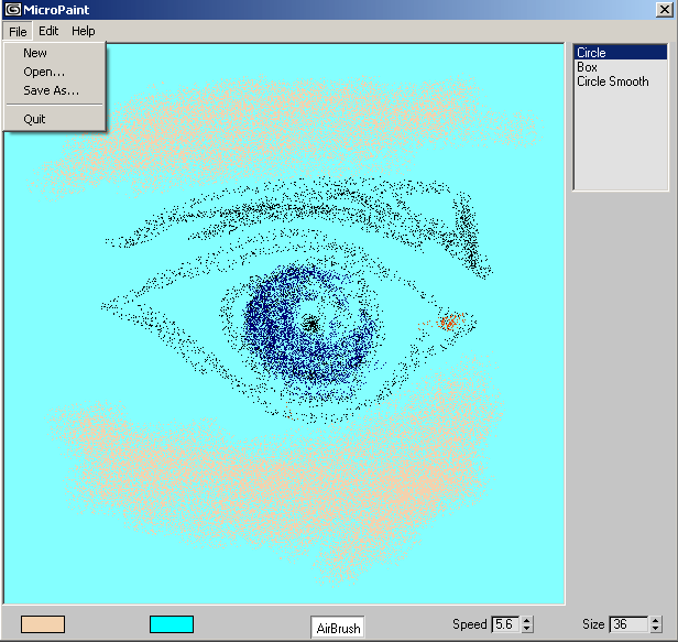

In this step of the Bitmap Painting tool development, we will add a main menu bar with New, Open, and Save options.
NATURAL LANGUAGE
We will define a new right-click menu with some menu items and corresponding event handlers.
We will assign the right-click menu as menu bar to the dialog.

rcMenu CanvasMenu (
This is a right-click menu definition.
subMenu "File" (
The first item in the menu will be called File. A typical program implements File, Edit, and Help items in its main menu, so we will define these too.
menuItem new_menu "New"
menuItem open_menu "Open..."
menuItem save_as "Save As..."
Inside the File menu, we will add some menu items to start a new drawing, open an existing one, and save the results to a file on disk.
separator file_menu_1
This is a separator that draws a horizontal line between the menu items.
menuItem quit_tool "Quit"
This menu item will be used to quit the tool.
subMenu "Edit" ( )
We will leave the Edit menu empty for now.
subMenu "Help"
menuItem about_tool "About MicroPaint..."
The Help menu will contain only the about item.

) createDialog MicroPaint_CanvasRollout (bitmapx+100) (bitmapy+30) menu:CanvasMenu
We add the RightClick menu defined in the beginning of the script to the dialog.
