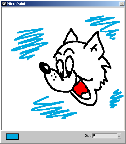

In this step of the Bitmap Painting tool development, we will add brush color and size controls.
NATURAL LANGUAGE
We will extend the existing MacroScript by adding new UI controls to the rollout to define the Ink color and the Brush Size.
The paintbrush function will be changed to use the color defined by the UI color picker.
The drawStroke function will be enhanced to draw a large rectangle based on the defined size.
SCRIPT:

rollout MicroPaint_CanvasRollout "MicroPaint"
bitmap theCanvas pos:[0,0] width:bitmapX height:bitmapY bitmap:theCanvasBitmap colorpicker inkColor height:16 modal:false color:black across:2
This is the color picker which will be used to define the color of the paintbrush.
spinner BrushSize "Size" range:[1,50,10] type:#integer fieldwidth:40
This spinner will define the size of the paintbrush.
fn paintBrush pos = (setPixels theCanvasBitmap pos)

( for b = -BrushSize.value/2 to BrushSize.value/2 do
This new loop will define the vertical size of the brush. It counts from minus half the size to plus half the size, full size altogether.
for c = -BrushSize.value/2 to BrushSize.value/2 do
This second loop defines the width of the paintbrush. It also loops from minus half the size to plus half the size, full size altogether.
paintBrush (currentPos + [c,b])
After each iteration of the c loop, we call our paint Brush function, passing the current position in the stroke plus the offset based on half the size of the brush and the b loop.
currentPos += [deltaStepX, deltaStepY]
theCanvas.bitmap = theCanvasBitmap

) createDialog MicroPaint_CanvasRollout bitmapX (bitmapY+30)
To accommodate the new User Interface controls for the color and brush size, we have to increase the vertical size of the dialog by 30 pixels.
