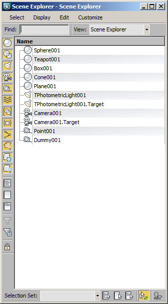

These dotNetObjects are implemented by the MaxCustomControls Assembly and provide access to the 3ds Max Scene Explorer framework.
dotNetObject "MaxCustomControls.SceneExplorerControls.SceneExplorerDialog"
This dotNetObject implements the modeless Scene Explorer dialog form.
EXAMPLE
theFrm = dotNetObject "MaxCustomControls.SceneExplorerControls.SceneExplorerDialog" thePtr = DotNetObject "System.IntPtr" (windows.getMAXHWND()) theHwnd = (dotNetObject "System.Windows.Forms.NativeWindow").FromHandle thePtr theFrm.Show(theHwnd)

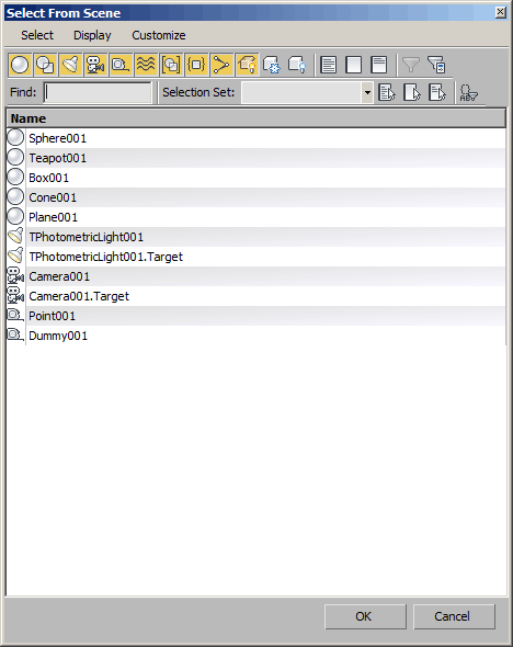

dotNetObject "MaxCustomControls.SceneExplorerControls.ModalSceneExplorerDialog"
This dotNetObject implements the modal Scene Explorer dialog form. Note that it does not block the main 3ds Max thread when opened and requires event handlers to be registered to be fully functional (e.g. return a selected object).
EXAMPLE
theFrm = dotNetObject "MaxCustomControls.SceneExplorerControls.ModalSceneExplorerDialog" thePtr = DotNetObject "System.IntPtr" (windows.getMAXHWND()) theHwnd = DotNetObject "MaxCustomControls.Win32HandleWrapper" thePtr theFrm.Show(theHwnd)
Constructors:
MaxCustomControls.SceneExplorerControls.ModalSceneExplorerDialog() MaxCustomControls.SceneExplorerControls.ModalSceneExplorerDialog <ExplorerFramework.DataFacade>aFacade

dotNetObject "MaxCustomControls.SceneExplorerControls. SceneExplorerCustomizationState"
Constructors:
MaxCustomControls.SceneExplorerControls.SceneExplorerCustomizationState() MaxCustomControls.SceneExplorerControls.SceneExplorerCustomizationState <System.Int32>aColumnCount
Properties:
.AdvancedFilterDataSource : <System.String>
.AdvancedFilterEnabled : <System.Boolean>
.AdvancedFilterLocation : <System.Drawing.Point>
.AdvancedFilterMatchAll : <System.Boolean>
.AdvancedFilterSize : <System.Drawing.Size>
.ChildrenCount : <System.Int32>, read-only
.ColumnWidth : <System.Int32[]>
.DisplayInfluences : <System.Boolean>
.EditingEnabled : <System.Boolean>
.FilterSelectionSetEnabled : <System.Boolean>
.FindCaseSensitive : <System.Boolean>
.FindStyleOption : <MaxCustomControls.QuickRegexFindHandler+FindStyle>
.InstanceName : <System.String>
.ParentState : <MaxCustomControls.ICustomizationState>
.SelectChildren : <System.Boolean>
.SelectDependents : <System.Boolean>
.SelectInfluences : <System.Boolean>
.ShowDependenciesEnabled : <System.Boolean>
.ShowFrozen : <System.Boolean>
.ShowHidden : <System.Boolean>
.ShowHierarchy : <System.Boolean>
.StateName : <System.String>
.SyncSelection : <System.Boolean>
.TopLevelControlState : <MaxCustomControls.FormCustomizationState>
.VisibleColumns : <System.String[]>
Methods:
.<System.Boolean>AddChild <MaxCustomControls.ICustomizationState>stateObject
.<System.Boolean>Equals <System.Object>obj
.[static]<System.Boolean>Equals <System.Object>objA <System.Object>objB
 .<MaxCustomControls.ICustomizationState>GetChildByIndex <System.Int32>index
 .<MaxCustomControls.ICustomizationState>GetChildByName <System.String>name
.<System.Int32>GetHashCode()
.<System.Type>GetType()
.<System.Boolean>LoadProperties <System.Collections.Generic.Dictionary`2[[System.String, mscorlib, Version=2.0.0.0, Culture=neutral, PublicKeyToken=b77a5c561934e089],[System.String, mscorlib, Version=2.0.0.0, Culture=neutral, PublicKeyToken=b77a5c561934e089]]>aPropertySet
.[static]<System.Boolean>ReferenceEquals <System.Object>objA <System.Object>objB
.<System.Boolean>RemoveChildByIndex <System.Int32>index
.<System.Boolean>RemoveChildByName <System.String>name
 .<System.Collections.Generic.Dictionary`2[System.String,System.String]>SaveProperties()
.<System.String>ToString()

dotNetObject "MaxCustomControls.SceneExplorerControls. DefaultModalExplorerCustomizationState"
This dotNetObject implements the modal Scene Explorer dialog's Customization State including the state of various filter icons and other options.
Constructors:
MaxCustomControls.SceneExplorerControls.DefaultModalExplorerCustomizationState()
Properties:
Methods:
