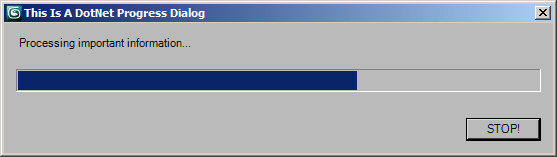

This dotNetObject is implemented by the MaxCustomControls Assembly and provides a Progress Dialog consisting of a DotNet Form with a Label, a Progressbar, and a Button featuring the 3ds Max Look-And-Feel including the current color scheme, 3ds Max icon, and others.
EXAMPLE
theObj = dotNetObject "MaxCustomControls.ProgressDialog" theObj.Show() theObj.text = "This Is A DotNet Progress Dialog" theObj.Controls.Item[0].text = "STOP!" theObj.Controls.Item[1].text = "Processing important information..." theObj.Controls.Item[2].value = 65
