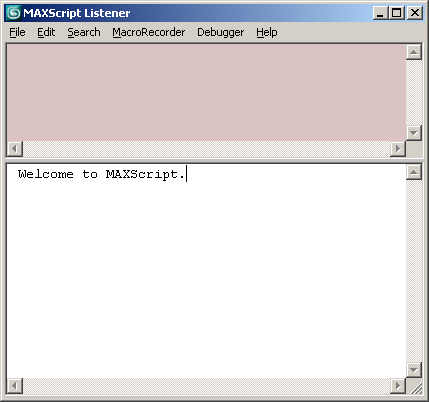

  2. Click Open Listener.
The MAXScript Listener window appears with its Welcome message.
The MAXScript Listener window is an interactive interpreter for the MAXScript language and works similarly to a DOS command prompt window. You can enter MAXScript commands in this window and press the numeric ENTER key to execute them immediately.
