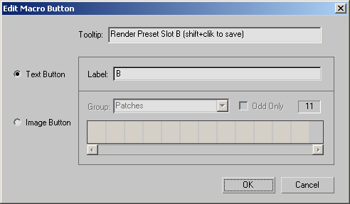

The Edit Button Appearance... option opens a new dialog whitewalls the user to control the appearance of the button including:
The Tooltip to be displayed when the mouse rolls over the button,
The Text Label when a Text Button is requested, and
The image file and the icon number to be used when an Image Button is desired.
This is the default appearance of the dialog. Eventhough the button is currently showing an icon (specified in the source code of the script), the dialog will provide the Text Button settings as the default state.
The user can switch the button mode to Image Button, select an icon library from the drop-down list (for example, "Render"), and select a new icon from the list:

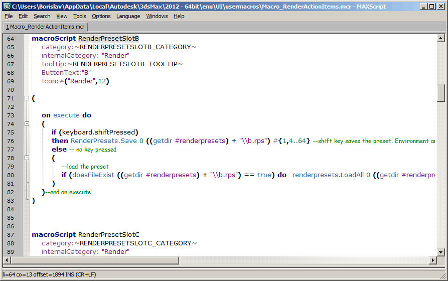

The Edit Macro Script option lets the user navigate directly to the source code of the MacroScript used for the button's definition. This can be very useful for quickly changing small errors in the functionality and for learning how certain features developed by Autodesk or 3 rd parties work.

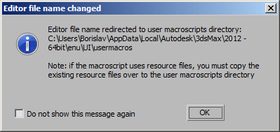

Note that opening a "factory" MacroScript that ships with 3ds Max will copy the file from the \macroscripts folder to the \usermacros folder in the current user's Local AppData folder to allow custom changes to the code. Scripts placed in the \usermacros folder will be evaluated after the factory scripts and will thus override them. The following warning will be shown by default (unless disabled via the checkbox option in the lower left corner):
For example, this is the MAXScript Editor showing the source code of the Render Presets Slot B button - note the first line of the MacroScript is automatically highlighted:

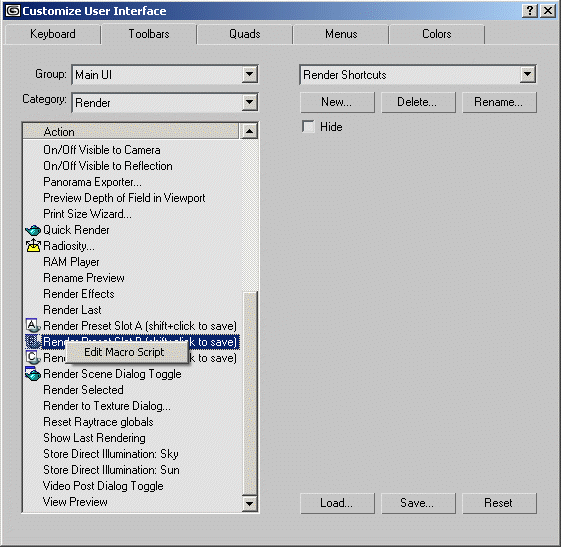

The Customize... option opens the standard Customize User Interface dialog and lets the user create new buttons, assign ActionItems to shortcuts, place them on Menus and QuadMenus, and tweak the colors of the User Interface. It also provides the option to locate and edit MacroScripts for those items that have been created using MAXScript:
