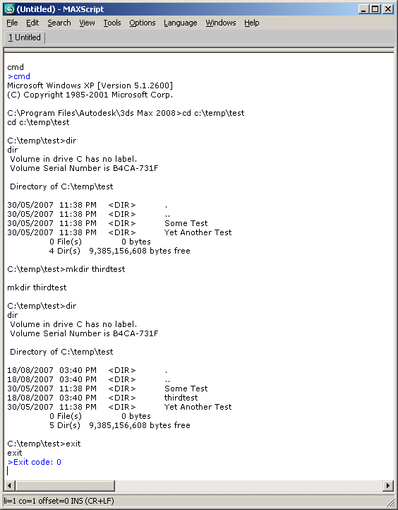

Using the Windows Command Shell
Some of the standard features of the Output pane can still be used in 3ds Max, for example typing in 'cmd' will launch a Windows Command Shell providing all DOS commands available in the stand-alone shell of MS Windows:
