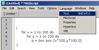

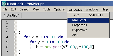

The Language menu of the Tabbed MAXScript Editor introduced in 3ds Max 2008 contains commands for switching the syntax coloring between the currently installed modes:
Text(SHIFT+F11) - no syntax coloring
MAXScript - default for .ms and .mcr files
Properties - default for .properties files
Hypertext - default for HTML files
XML - default for XML files
