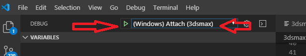

To attach to the process, first choose the "(Windows) Attach (3dsmax)" item in the debug dropdown and then press the green triangle to start it.
Start C++

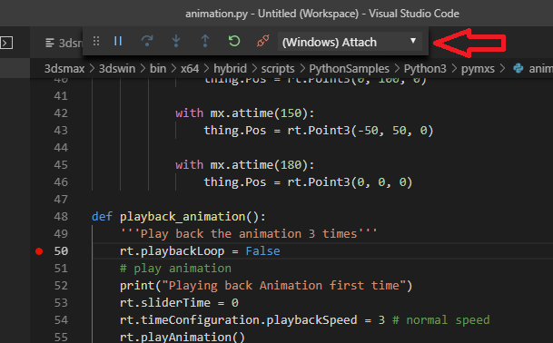

Debugging
From the moment the configurations are attached to the running application it becomes possible to select them to debug one or the other aspect of the running application:
PythonView
CPPView
As shown, at the same moment the application may look as stopped on a python breakpoint and running (not stopped) in C++.
