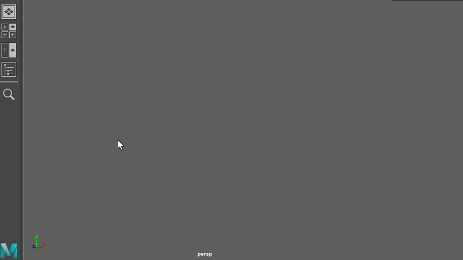

To search for a menu / tool / command
- Click the Search icon (
) under the
Toolbox or press Ctrl + F to open the
Search field.
- (Optional) Click the mode button to the left of the search field to switch to the appropriate mode.
