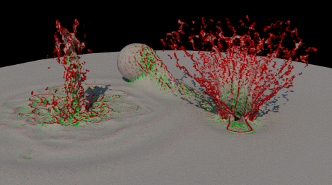

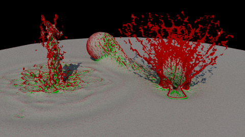

Particle Display
Controls the display when
Particles is checked in the
Display attributes.
Type
- Displays particles as
Point sprites or
Sphere instances.
Max Particle Display Count
- Allows you to display fewer particles in the viewport than are actually simulated, to speed up drawing and free up graphics memory while still displaying a useful preview of the overall particle flow.
Note that for very low values, the number of particles displayed may exceed the value of
Max Particle Display Count because the particles get distributed as evenly as possible across the voxels.
In addition, particles are drawn in batches, so it's possible to display more particles than can fit in graphics memory at one time. However, drawing and interactivity will be slower.
Note: If this value is small compared to the total number of particles, you may notice artifacts in the viewport, such as repetitive particle distribution. However, rendering is not affected.

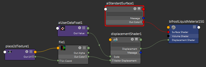

To blend with a flat mesh using displacement:
- Specify the flat plane for which the displacement map was created as the
Mesh Plane.
- Specify the name of the
Output Channel to use for blending. The default is
ocean.
- Add the same channel name to the
Export Channels list.
- In the
Hypershade window, add a displacement shader to the liquid material. For more information about working in the
Hypershade window in general, see
Hypershade window.
- Connect a
File texture node to the displacement shader's
Vector Displacement attribute.
- Specify the displacement map in the File node's
Image Name attribute.
- Use a utility shader to get the
Output Channel you specified (for example,
ocean) and connect it to the displacement shader's
Scale attribute. The name of the shader and the procedure for this step depend on your renderer.
- Adjust the
Boundary Radius and
Offsets to control the blend.
