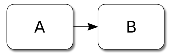

After partitioning, the EM must schedule nodes for evaluation in the correct order. Nodes are scheduled so that upstream nodes are evaluated before all dependents. Beyond this, it's not possible to guarantee any particular order of evaluation.
For example, in the simple graph,
node A always evaluates before B. For a more complex graph,

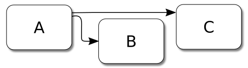

although A is guaranteed to be evaluated before B and C, there are no guarantees about the exact timing of evaluation for B and C. Depending on the scheduling type of B and C, they could be evaluated simultaneously.
