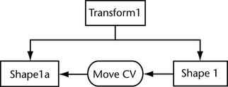

A transform node can have any number of transform nodes as children. In general, a transform node can only have a single shape node as a child, and when viewing the DAG through an interactive window this will always be the case. However when examining the DAG through the API you will find that transforms may have multiple shape nodes as children. This happens when the original shape under the transform has been modified by the dependency graph. To maintain the transformations on the result of the dependency graph, the result is placed under the same transform as the original node. The new node would have the same DAG transforms applied as the original, but would be modified in some way (for example, its CVs could have been moved). When this happens, only the final product is visible in an interactive window, and the original nodes are historical.
|Transform1|Shape1 is the original historical object while |Transform1|Shape1a is the actual object visible in any interactive window. |Transform1|Shape1 is also called an intermediate object.This is important later when working with the dependency graph.
MDagPath::extendToShape() method on a path whose last node is a transform that contains multiple shapes, the first child shape node will be the node that is added onto the end of the path. If this is not the desired node, it is recommended that you not use the extendToShape() method. Instead, use the MDagPath::child() and MDagPath::childCount() methods to help examine and access the desired shape node.Additionally, there is an MDagPath::extendToShapeDirectlyBelow(unsigned int index) method that can be used to extend to the correct child shape.
