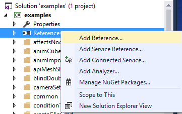

To build the examples:
openmayacs.dll
to the project references. %MAYA_LOCATION%\bin\
and add openmayacs.dll
to the references. If you had previously added openmaycs.dll
to a project, it will be visible under your recent items. In this case, simply select the dll.The built examples will be located in the assemblies
