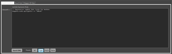

The DagExplorer example shows how close the interaction between Maya and the .NET interface can be. In the Search Condition tab, you can specify a search condition in the form of a C# lambda expression. At the bottom, there are four preset lambdas.

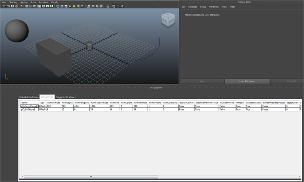

When the Search DAG button is clicked, this expression is applied via LINQ to Maya’s DAG, and the results are displayed in the Result Grid tab in a property grid.
Selecting an item in the property grid also selects it in the Maya scene view, and in addition, it is displayed in the Polygon 3D View tab.

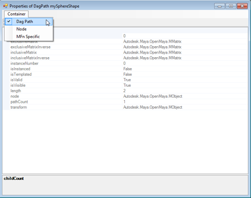

Double-click an entry in the property grid and a window appears that displays the properties of the selected node. Click the Container menu to view the properties for each of the dagpath, the node, and the MFn class, for example, MFnMesh.
You can set any of the properties via this window and see the results instantaneously in Maya.
