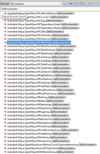

, and so forth. To see all classes that implement IEnumerable<T>
you can use the Object Browser to search for GetEnumerator()
Any class that implements a GetEnumerator()
