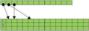

A simple example of a set of data held by an MGeometry
instance is a set data streams for position, normal and color data, as required by a shader. A single set of indices could describe the set of connected triangle primitives.
Figure 18: Each item in the index list defines a data offset into a position (P), normal (N) and color (C) vertex buffer. Three indices are used per triangle.

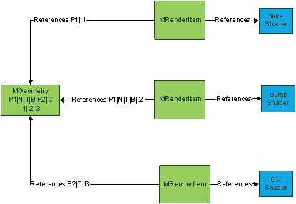

MGeometry
can hold the data and indexing required for rendering many shaders. There can thus be a complex set of data and indexing combinations depending on the requirements of a given shader.
In the previous example where an object (torus) required geometry for filled shading, wireframe draw and control point draw: the total set of data streams required are two position streams, one normal stream, one tangent stream, one bitangent stream and one color stream. Three indexing streams are also required – one for each render item.
Figure 19
In this example there is one MGeometry
instance with P1 and P2 as positions; N, T, B as normal, tangent and bitangent; and C as a color stream. I1 is the indexing that describes the connected wireframe line segments, I2 the indexing that describes the triangle mesh for filled drawing and I3 the indexing for the control vertex points. Note in this scenario that P1 is reused for both wire and shaded drawing.

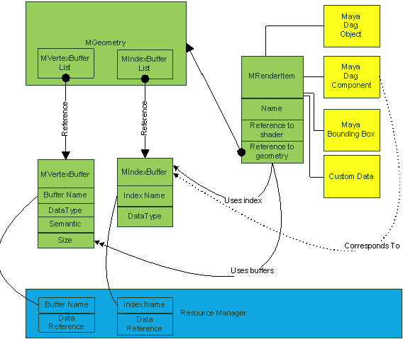

To put all of the pieces together for MGeometry
, Figure 20 below illustrates an instance of MGeometry
, MIndexBuffer
, MVertexBuffer
, MRenderItem
and the internal resource manager.
Figure 21: The MRenderItem
references an MGeometry
instance. The MGeometry
instance references one or more MVertexBuffer
instances, and zero or more MIndexBuffer
instances. The MRenderItem
keeps information about the specific MVertexBuffers
and MIndexBuffer
it uses. Any Maya DAG component can correspond to a specific MIndexBuffer
. The data for MVertexBuffer
and MIndexBuffer
is managed by the internal resource manager which interacts directly with the GPU data.
This diagram shows a series of dependencies represented as connecting lines. The direction of arrows shows the direction of dependency. Each dependency is a reference and the collection of references shows how lifetime management is handled. The resource manager always references the actual geometric data. MVertexBuffer and MIndexBuffer instances hold references to their corresponding GPU data. MGeometry holds references to all the MVertexBuffer and MIndexBuffer instances for a renderable object. MRenderItem references specific MVertexBuffer and MIndexBuffer instances it uses.

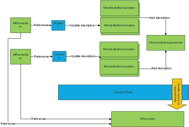

The previous sections have discussed static geometry data structures and their relationships to one another. During the update phase, instances of these structures need to be instantiated and filled in.
We call this step fulfilling geometry requirements.
Within the API, the corresponding class that specifies what to fulfill is an MGeometryRequirements
An instance of this class represents the hand-shake mechanism between shaders and locations where data is filled. Each shader for a render item puts forth its requirements. The cumulative set of requirements is collected and presented in a single instance of MGeometryRequirements
Requirements are specified by a set of vertex buffers descriptors (MVertexBufferDescriptor
) and a set of index buffer descriptors (MIndexBufferDescriptor
A round-trip update of geometric data is shown in the following diagram. Some geometry needs to be updated for a set of shaders. The requirements are gathered, fulfilled, and the geometry required for shading is updated.
Figure 22: In this example, a few render items are shown. The shader for each respective render item specifies a set of descriptors (index or data) and the descriptors are accumulated into a single MGeometryRequirements
instance. When an update is required, those requirements are fulfilled and the resulting data cached and referenced by an MGeometry
instance. In this particular case, all render items reference this MGeometry
instance, and use this data during the rendering phase.

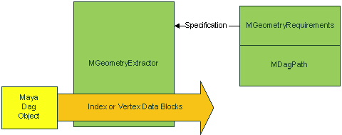

It is sometimes useful to be able to extract geometry from the resource manager outside the context of updating a render item, or outside the context of the rendering pipeline itself.
To do this, use the MGeometryExtractor
interface. The interface is intended to provide non-renderer specific geometry data from Maya DAG objects.
It is the preferred mechanism to replace the old interface (called MGeometryManager
). Though it is still possible to use either the old or the new interface or to even use functional interfaces for objects (MFn*
), the existing interfaces do not take advantage of all the properties of the new interface:
MFn*
interfaces)MGeometryRequirements
).Currently, only polygonal object types are supported.
Figure 23: For a given DAG path, a set of geometry requirements is passed to the extractor. From the associated DAG object, a set of index or vertex data blocks can be extracted.
