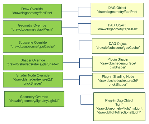

<override classification> : Unique override classification. Often, this is the name of the node type the override is to be used with (if it is not used with multiple node types).
Figure 35: For each override type the classification matches any objects or nodes specified in the classification.

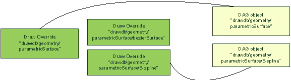

Figure 36: Example demonstrating that, depending on how on how specific the classification is, different matches results. The “drawdb/geometry/parametricSurface/B-spline
” DAG object classification matches more closely to the override with the identical classification string, rather than the more generic “drawdb/geometry/parametricSurface
” string. The classification with the closest match is used.

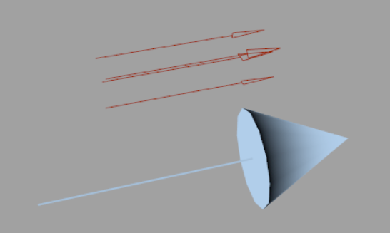

A simple example is given in the apiDirectionalLightShape plug-in example, which draws the following custom geometry (in blue) as compared to the default internal drawing of a directional light.
