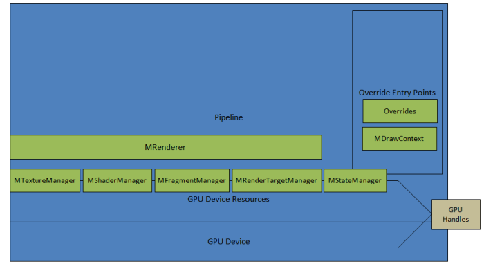

Figure 37: At the core is a GPU device initiated to run a specific draw API. Various GPU handles, specific to that draw API, can be accessed via the constructs exposed by the API managers or renderer. The renderer, along with the texture, shader, fragment and target managers are accessible anytime in the pipeline. Overrides are active only during certain times in the pipeline. Within this time, a draw context can be accessed. The acquire and release methods of the state manager are accessible anytime in the pipeline, but state blocks may only be activated to the device when an MDrawContext is available.
