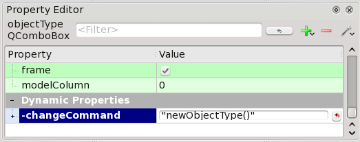

The image below shows the -changeCommand property being added to the comboBox in Qt Designer.
When the corresponding optionMenu control is created, its -changeCommand flag will be set to execute the command string "newObjectType()".
