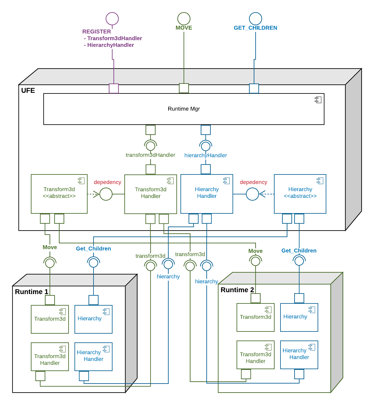

The following component diagram illustrates the responsibilities and dependencies of the different objects.
Component Diagram

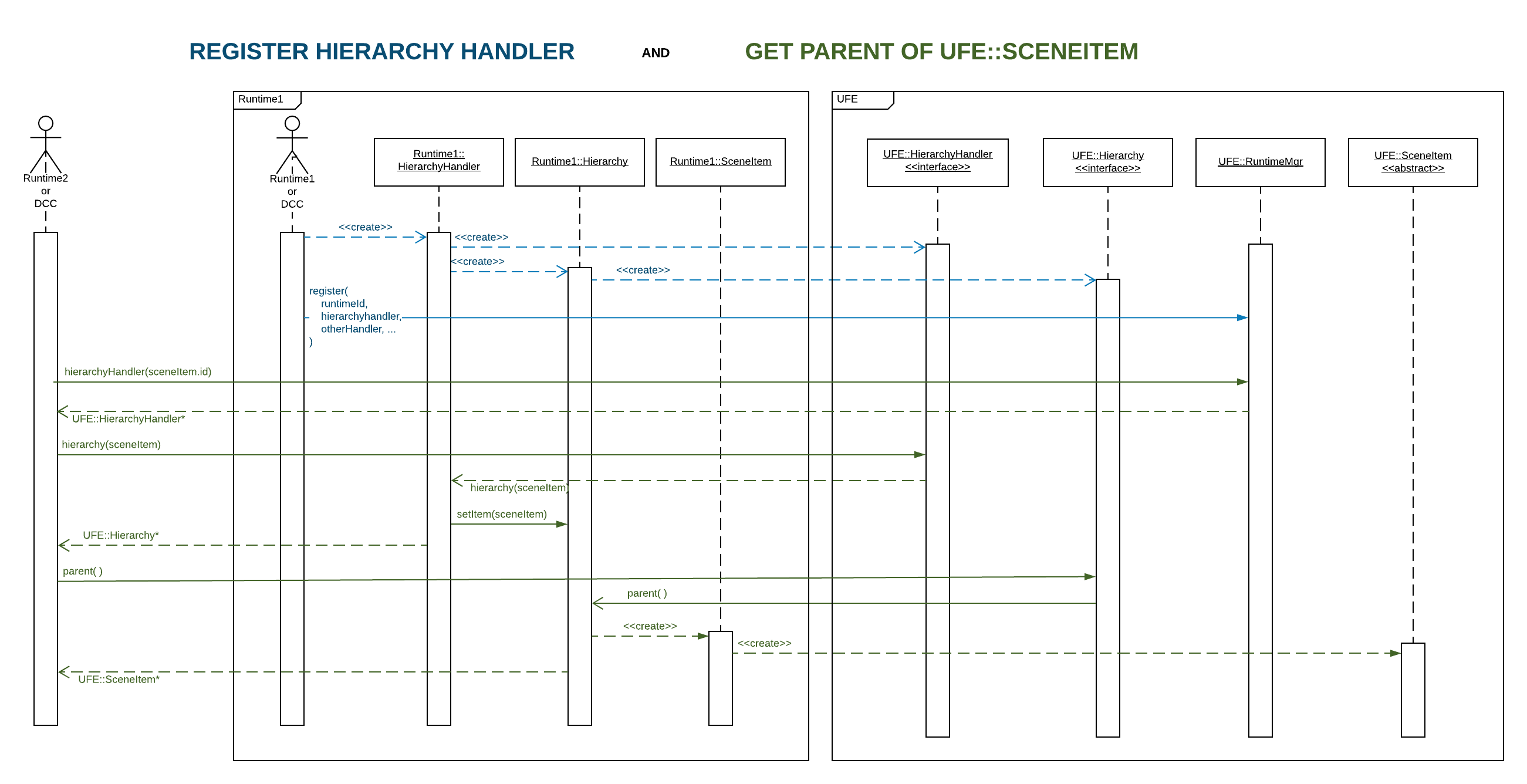

The following sequence diagram illustrates the flow of control between the different components and objects.
Sequence Diagram
