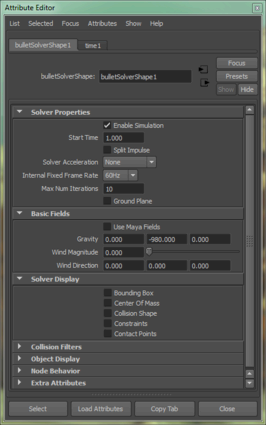

When you add Bullet objects to a Maya scene, a
bulletSolverShape node is created. This node’s attributes manage the overall Bullet physics settings that apply to the entire scene including gravity and wind, and the solver engine that is used (OpenCL CPU, OpenCLGPU).

Solver Properties
Enable Simulation
- Activate this to initiate the simulation process and enable the settings.
Start Time
- Sets the time (in frames) that the Bullet simulation begins. By setting this attribute to a value greater than 1, you can animate the scene for an interval before the Bullet objects begin moving.
Split Impulse
- When enabled, this option nullifies any velocity that is created to separate interpenetrating objects at the start of the simulation. This is useful to prevent objects from flying violently apart while they are settling into their initial positions.
Solver Acceleration
- The soft body solver in Bullet can be greatly accelerated using OpenCL on systems with OpenCL support. This option enables Bullet to take advantage of parallel computing resources such as multiple CPU cores or the graphics processing unit (GPU). For systems without GPU support, the solver can still be significantly accelerated using a CPU-only version of the OpenCL solver, which takes advantage of multiple CPU cores.
Note: Solver Acceleration only affects soft bodies, not rigid bodies. Rigid body calculations will be done on the CPU.
Internal Fixed Frame Rate
- Sets the rate at which the Bullet physics simulation updates. This setting defines the resolution of the simulation. If the collisions fail to occur due to fast moving objects, reduce the time step by increasing Internal Fixed Frame Rate. See the Bullet Physics Manual at www.bulletphysics.org for more information.

Basic Fields
Use Maya Fields
- Activate this option when you want to use Maya Fields instead of the Bullet Basic Fields. See Bullet and Maya Fields.
Note: Activating Use Maya Fields disables the Bullet Gravity, Wind Magnitude, and Wind Direction settings, below. However, when you use the Maya Field settings, you must remember to set the gravity settings no matter which other fields you use.
Gravity
- Specifies the vector representing acceleration due to gravity. Gravity affects all dynamic objects in the scene.
Note: The default Gravity setting is -9.8.

Solver Display
The Solver Display settings concern the display of the Rigid Sets and the Glue constraint.
