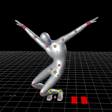

You can refer to this topic to gain a basic understanding of how to use Python in MotionBuilder. Additionally, some important classes and concepts are explained in this topic for understanding how to use Python.
The Dancing Man program described in this topic constrains a character's hip effector to the screen coordinates (x,y) of the mouse. At the end of this step-by-step tutorial, a character appears to dance in the scene when you move the mouse. The image below shows the result of The Dancing Man program.

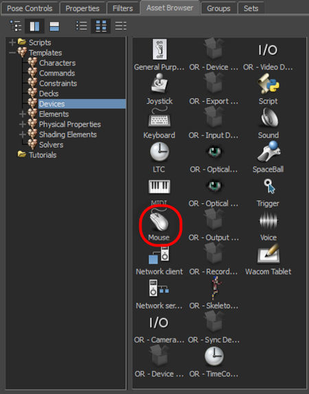

To use the mouse as an input device, you need to add a mouse (FBDevice) to the scene. You can use the FBCreateObject() function to obtain a mouse device. After the mouse object is created, you must activate it (FBDevice.OnLine), allow the application to read its data (FBBox.Live) , and append it to the scene's list of devices (FBScene.Devices).
# Create a mouse device and append it to the scene.
mouseDevice = FBCreateObject("Browsing/Templates/Devices", "Mouse", "MyMouse")
mouseDevice.OnLine = True
mouseDevice.Live = True
scene.Devices.append(mouseDevice)
The FBCreateObject() function is used to create objects from within the Asset Browser window. Following are the arguments of FBCreateObject():
"Browsing/Templates/Devices" - The Asset Browser path. This path is illustrated by the node hierarchy in the navigation tree. This path must always begin with Browsing/."Mouse" - The entry name. It corresponds to the red circle in the following figure.Argument 3: "MyMouse" - The custom name of the object.
"Browsing/Templates/Elements/Primitives", the custom name must be the same as the entry name. For more information, refer to the BasicOperations/ObjectCreation.py example in the Python API Reference section.You can now constrain the character's hips effector to the mouse input. To do this, create a new FBConstraintRelation, and name it "DanceConstraint".

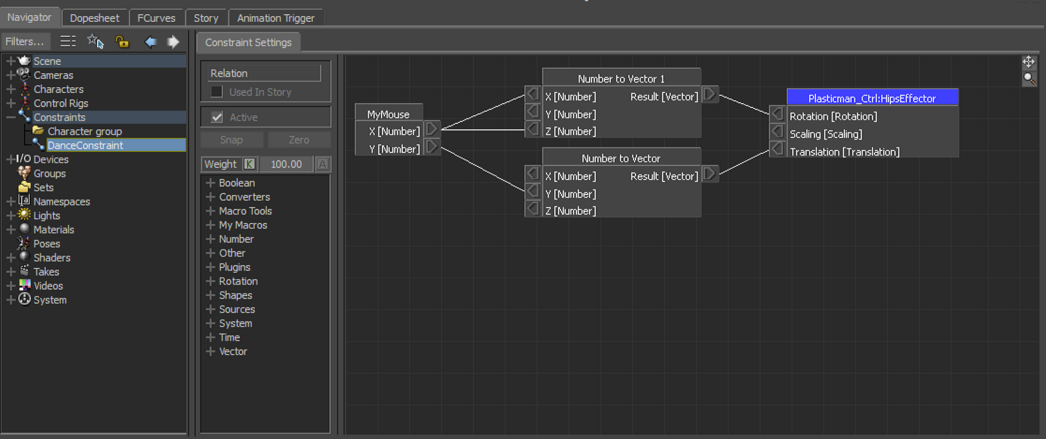

The following figure illustrates how the hips effector is constrained by the mouse. Instances of FBBox and FBAnimationNode are used in an FBConstraintRelation to define the behavior of the constraint.
FBBox Base ClassFBBox is the base class of any animatable element in the scene including models (FBModel), lights (FBLight), materials (FBMaterial), textures (FBTexture), shaders (FBShader), constraints (FBConstraint), and so on. Our FBConstraintRelation contains a set of FBBox objects. In the figure, the boxes MyMouse, Number to Vector, Number to Vector 1, and Plasticman_Ctrl:HipsEffector are all instances of FBBox. Each instance of FBBox performs a specific role in the FBConstraintRelation.
MyMouse box acts as a data source.Plasticman_Ctrl:HipsEffector box is being constrained.Number to Vector and Number to Vector 1 boxes convert the X and Y data from the mouse into 3D vectors.The following code sample shows how to create these boxes and set their position in the Constraint Settings window.
# 1. Create a box for the mouse's output.
mouseBox = constraintRelation.SetAsSource(mouseDevice)
constraintRelation.SetBoxPosition(mouseBox, 30, 30)
# 2. Create a box for the hip effector's input.
hipEffectorBox = constraintRelation.ConstrainObject(hipEffector)
constraintRelation.SetBoxPosition(hipEffectorBox, 700, 30)
# 3. Create a number to vector box to map the 'Y' output of the mouse
# to the 'Y' translation of the PlasticMan's hip effector.
translationConversionBox = constraintRelation.CreateFunctionBox('Converters', 'Number to Vector')
constraintRelation.SetBoxPosition(translationConversionBox, 300, 100)
# 4. Create a number to vector box to map the 'X' output of the mouse
# to the 'X' and 'Z' rotation of the PlasticMan's hip effector.
rotationConversionBox = constraintRelation.CreateFunctionBox('Converters', 'Number to Vector')
constraintRelation.SetBoxPosition(rotationConversionBox, 300, 0)
