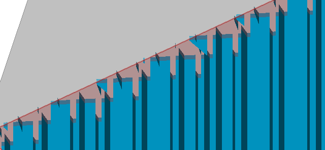

Fixed a bug in support generation where a combination of thin part and increased part intrusion would cause supports to be generated in triangular fragments
NC-14298 |
