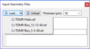

Load files via dialog, or choose a recent file from the dropdown menu:

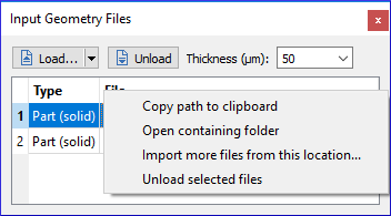

Once loaded, use a file's context menu for additional tasks:

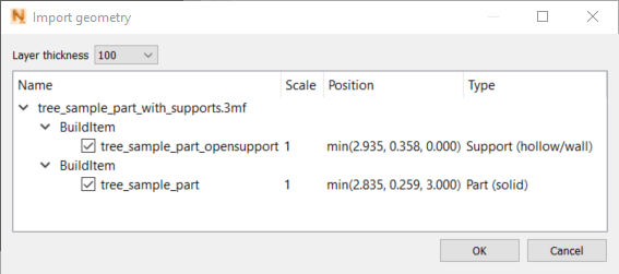

A file may contain more than one object.
For example, when loading a 3MF file, you may import the meshes for part and support geometry from one file.
For each item in the file you can configure attributes:
Hollow objects do not define a volume. So, the imported mesh is defining an object of zero thickness. In general this is only useful for supports.
