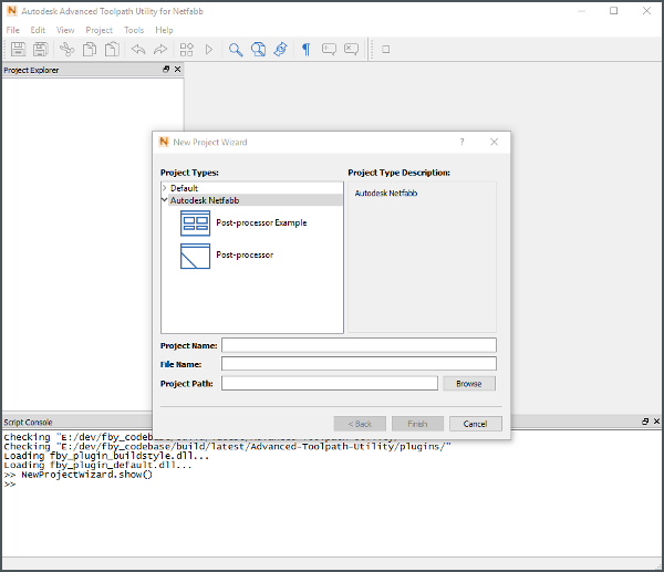

Creating a Post-Processor Project
Choose File > New > New Project.
Enter a Project Name.
Browse to select a path for the new project, create a new empty folder, and click Select Folder.
Click Finish.

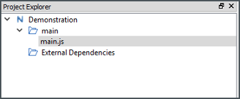

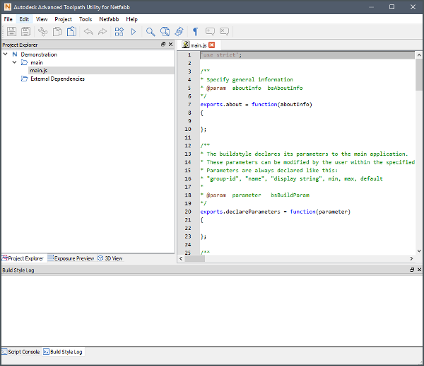

A new project is created containing several script files. Once a project is loaded several new windows may open. The windows can be arranged freely. The program will save the window layout for future sessions. If a window is closed, open it from the View menu.
In the Project Explorer, the script files, which are part of the project, are listed. At the moment there is just one file.
The file main.js contains the implementations of the different entry points.

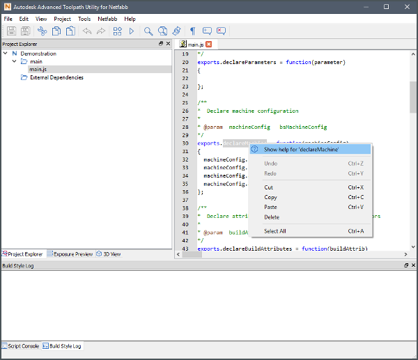

Double-click main.js to open it.
You can get information about the entry point functions by right-clicking a function’s name and choosing Show help for....

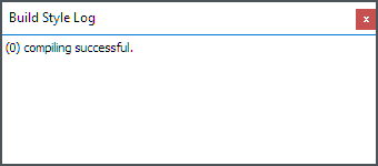

Choose Project > Compile (or press F7) to compile the project. See the Build Style Log window to check for errors. If the window is closed, choose View > Build Style Log.

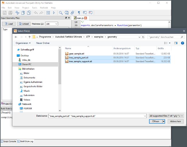

In the Input Geometry Files window, click Load to import one or more files. Supported file formats are STL, PLY, and OBJ. Any number of files can be loaded. Demonstration files can be located here: C:\ProgramData\Autodesk\ATU\ATU-Examples\Geometry files
Extract the tree_sample.zip and tree_sample_support.zip files located here: C:\ProgramData\Autodesk\ATU\ATU-Examples\Geometry files and move the extracted files to the geometry folder.
Tip: If you add multiple geometry input files to your project, those files will be passed to your post-processor as a single part.

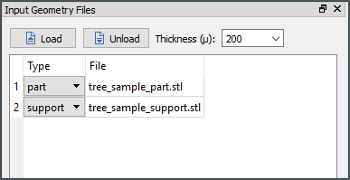

In the geometry folder, select tree_sample_part.stl and tree_sample_support.stl and click Open.
Now you will be asked for the layer thickness which should be applied to the input geometry. This thickness should match the layer thickness at which your post-processor is intended to work on.
Enter 200 and click OK.
While importing 3D geometry, you can specify a type for every geometry object. Later on, it is possible to treat each type differently.
Option Description
part Geometry for a part
solid support Support geometry, that will be printed solid
hollow/wall support Geometry for a support structure, that is hollow or does not have empty space inside
For tree_sample_part.stl, select part.
For tree_sample_support.stl, select hollow/wall support.
The Input Geometry Files window should now look like this:

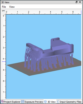

Watch the Input Geometry in the 3D View
In the 3D View window, you’ll see the input geometry. Use the mouse-wheel to zoom in and out. Hold down the middle mouse button to rotate. Hold down the middle mouse button and Shift key to pan. A transparent plane shows the current position of the 2D exposure preview.

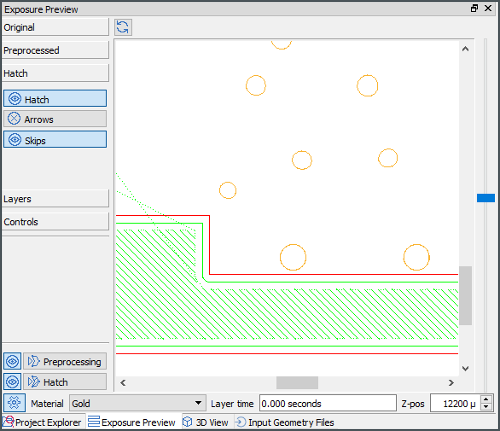

Watch the Input Geometry in 2D
In the Exposure Preview window, you’ll see one layer of the input geometry. The slider on the right lets you navigate through the layers. On the left side the view options are accessible. For example, you could choose Controls > Ruler to check the dimensions of your input geometry. The view options can be hidden/shown by clicking the button on the bottom left.
Red lines are island borders to be filled with material. Orange lines are open polylines are usually supports because the part should only have closed polygons. Later on, you will also see green lines. These will be the exposure data generated by the script.
Use the mouse wheel to zoom. Press and hold the left mouse button to pan. Double-click the left mouse button to reset the view.

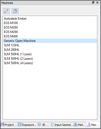

Configure the Post-Processor for a Machine
If necessary, use the Project Explorer window to open the file, main.js. Find the function declareMachine. To see which options are available, open the help page bsMachineConfig. The function declareMachine will specify for which machine, material, and layer thickness the post-processor can be used. Now change the defaults so that the function looks like this:
exports.declareMachine = function(machineConfig)
   machineConfig.setBuildstyleName("test01"); // set buildstyle name
   machineConfig.setMachineName("Generic Open Machine"); // set machine name
   machineConfig.addMaterialName("Gold"); // set name of first material
   machineConfig.addMaterialName("Steel"); // set name of second material
   machineConfig.addLayerThickness(200); // set layer thickness option
Press F7 to compile and check the Build Style Log for errors.
The script should compile without any errors.

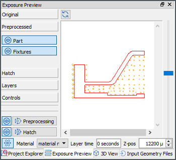

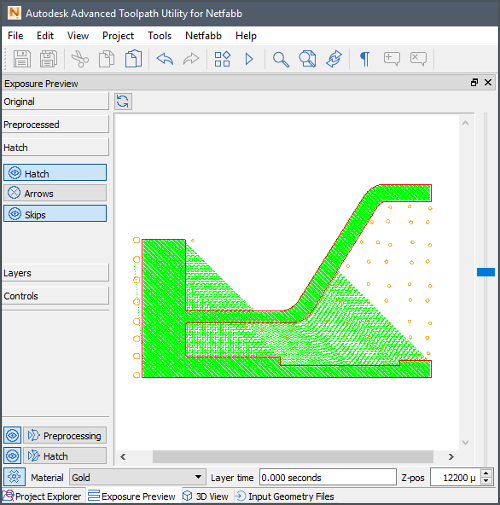

Now, look at the Exposure Preview window.
Move the Z-position to 15000.
The part-area is filled with a hatch pattern.
On the left side of the Exposure Preview window, click Hatch.
Click Skips.
The skip vectors are drawn additionally.
Choose Controls > Animate.
An additional slider occurs below the Exposure Preview window. Move the slider to see how the area is filled.
The hatch filling can be optimized by enabling the block-sort feature. Change this one line in the script code:
island.hatch(hatchData, 0.1, 45.0, HATCH.nHatchFlagBlocksort);
Press F7 to compile.
Move the animate slider again to see how the filling strategy has changed. You could also combine different flags like this to optimize the path even more:
island.hatch(hatchData, 0.1, 45.0, HATCH.nHatchFlagBlocksort | HATCH.nHatchFlagAlternating);

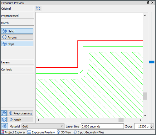

We will now create an additional border path. Change the code like this:
exports.makeExposureLayer = function(modelData, hatchResult, nLayerNr)
   var iter = modelData.getFirstIsland(nLayerNr);
   while(iter.isValid())
      var off1 = new ISLAND.bsIsland();
      iter.getIsland().createOffset(off1, -0.15); // first border path parallel to the island border
      var off2 = new ISLAND.bsIsland();
      iter.getIsland().createOffset(off2, -0.30); // second border path parallel to the island border
      var hatchData = new HATCH.bsHatch();
      off2.hatch(hatchData, 0.1, 45.0, HATCH.nHatchFlagBlocksort | HATCH.nHatchFlagAlternating); // this step creates the hatch pattern filling the inner border path (off2)
      hatchResult.moveDataFrom(hatchData);
      var borderPath = new HATCH.bsHatch();
      off1.borderToHatch(borderPath);   // generates a toolpath for the outer border path, without adding a hatch pattern
      hatchResult.moveDataFrom(borderPath);
      iter.next();
After compiling again the preview should look like this (zoomed into a detail):

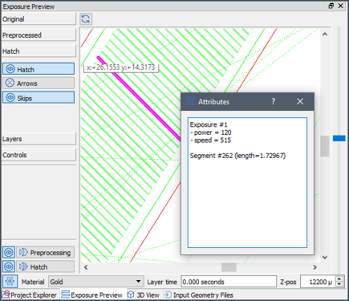

Assigning Attributes to Toolpaths
An arbitrary number of attributes can be assigned to a toolpath. This information can be accessed later on while exporting the data to a file where it may be necessary to store special processing parameters for the machine. Attributes can be assigned to a polyline, to a separate segment, or a separate point within a polyline.
Find the function declareBuildAttributes.

Open the Exposure Preview window.
Click any green toolpath segment to select it.
Right-click and choose Attribute Info.
Now you can watch the attributes of each segment while you move the mouse from segment to segment.

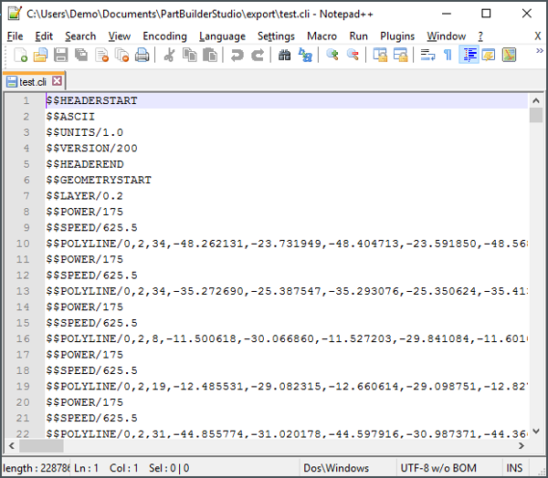

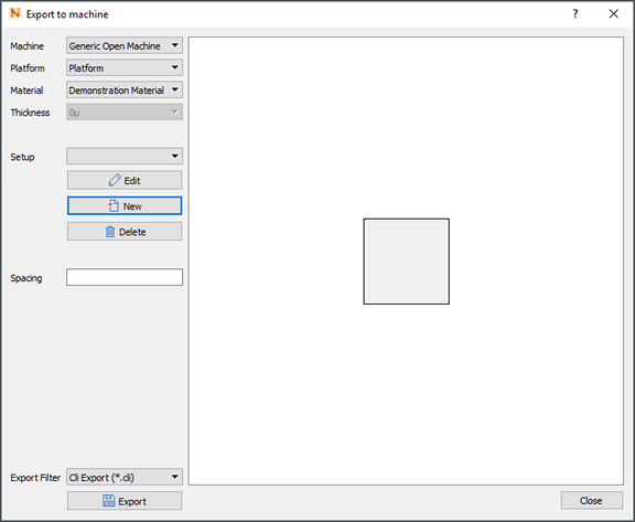

Exporting to CLI
The next thing we want to do is to export the calculated toolpath to a file. For example, we can export the data to a CLI file. (Other formats can be used. Examples are pictures for the ember machine or binary formats for Renishaw machines.)

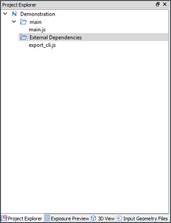

In the Project Explorer window, right-click the root node test01 and choose Add Existing File.
From the Scripts folder, select the file export_cli.js.
Your project should look like this:
Add these lines to the top of main.js to make CLI and the export filter available.
var EXPORT_FILTER = requireBuiltin("bsExportFilter");
var CLI = require("export_cli.js");

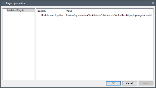

A compile error may occur because the file export_cli.js cannot be found. Choose Project > Properties.
Adding locations to the Module Search Path, tells the toolpath processor to look for JavaScript include files in all specified locations. In the sample code above, the require function includes the JavaScript code of the file export_cli.js to you current file. You can create JavaScript libraries, that can be reused in different buildstyles, and store them in central locations. The toolpath processor finds these file, if you set the Module Include Path to that central location.
In the main.js file, find the function declareExportFilter.
Declare the CLI export filter like this:
exports.declareExportFilter = function(exportFilter)
   exportFilter.declareFilter("CLI", "CLI File", "cli",
      CLI.version.major, CLI.version.minor,
      EXPORT_FILTER.nExportFilterSingleFile);
Find the function exportToFile and implement the CLI export as follows:
exports.exportToFile = function(
  exportFile,
  sFilter,
  modelData,
  progress)
    if(sFilter == "CLI")
      // export to cli format
      var exporter = new CLI.cliExport(1.0,

      exporter.addExportAttributeInt("power", "POWER");
      exporter.addExportAttributeReal("speed", "SPEED");
      exporter.exportCli(exportFile, modelData, progress);
      return;
   process.printError("unsupported export filter " + sFilter);
   return;
The post-processor is now able to export the toolpath to a CLI file.

In the main.js file, change the function makeExposureLayer like this:
    var fBeamComp = PARAM.getParamReal("exposure", "_bcomp");
    var nAngle = PARAM.getParamInt("exposure", "_hatchAngle");
    iter.getIsland().createOffset(off1, -fBeamComp);
    iter.getIsland().createOffset(off2, -fBeamComp-0.15);
    off2.hatch(hatchData, 0.1, nAngle, HATCH.nHatchFlagBlocksort | HATCH.nHatchFlagAlternating);
    hatchData.setAttributeInt("power", 120);
    hatchData.setAttributeReal("speed", 515.0);
    borderPath.setAttributeInt("power", 60);
    borderPath.setAttributeReal("speed", 390.5);
    iter.next();
 iter = modelData.getFirstLayerPolyline(nLayerNr, POLY_IT.nLayerOpenPolylines);
    var polylineHatch = new HATCH.bsHatch();
    iter.polylineToHatch(polylineHatch);
    polylineHatch.setAttributeInt("power", 175);
    polylineHatch.setAttributeReal("speed", 625.5);
    hatchResult.moveDataFrom(polylineHatch);
    iter.next();

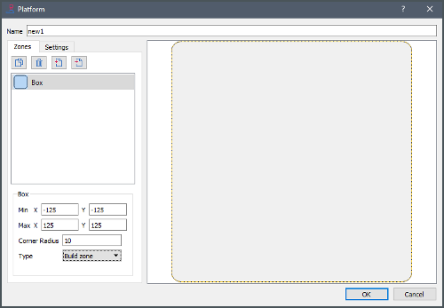

From the Machines window, click Add New.
In the opening dialog box, set the machine name Generic Open Machine.
In the blank platforms area, right-click to create a new platform.
Double-click the new platform to open the Platform dialog box.
On the Zones tab, select the Box zone to see the zone settings.
Set the Min and Max values to -125/+125, respectively, to define a build envelope large enough for our test. Then close the Platform dialog box and the Machine dialog box.

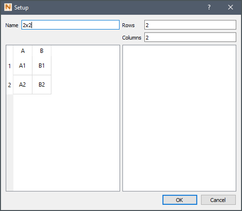

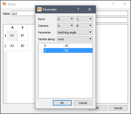

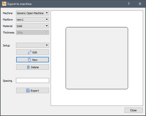

Now we are ready to export a test build. Choose Netfabb > Export Test Build.

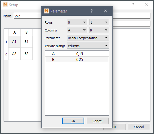

Click New to create a setup.
Enter a name, such as 2x2, and set the Rows and Columns to 2.
Drag the mouse over the table view so that all four cells are selected.
Then right-click and choose New Variation....
The Parameter dialog box will open.
Configure the parameters so that the beam compensation will change from column A to column B.
Then click OK.
Mouse over the table cells to verify that the parameter is assigned properly.
Repeat the step to add a variation of the hatching angle. This time let it vary over the rows.
If all values are acceptable, click OK.
Set a spacing of 10 mm so that there is a distance between the parts on the test platform.

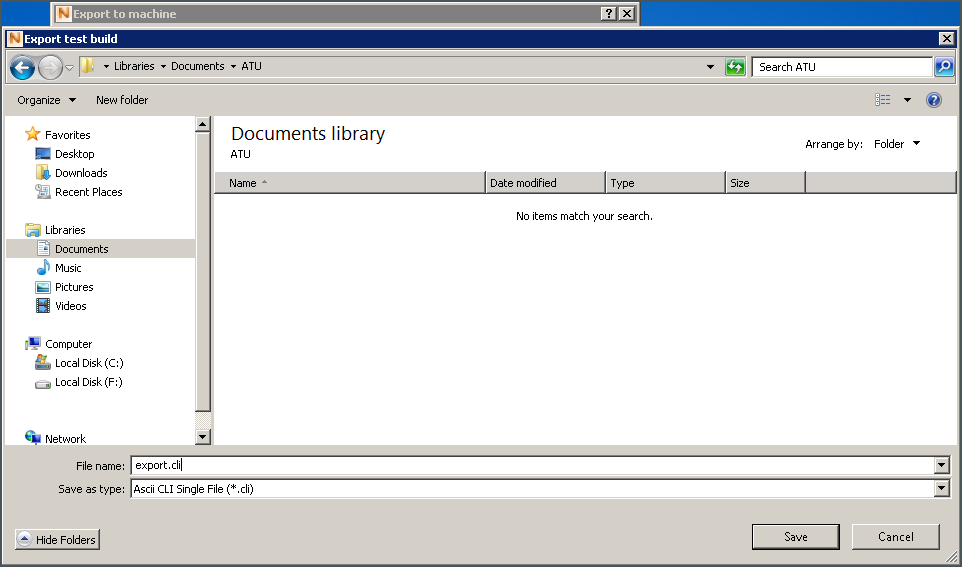

Then click Export. Enter a file name and click Save.
The test platform will be calculated and written to the specified file. If you open the CLI file with a text editor, you can see the specified attributes POWER and SPEED are written before each polyline.
