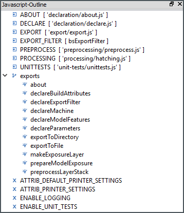

JavaScript-Outline
The JavaScript-Outline control creates a structured overview of JavaScript elements within the open file. Clicking an element positions the cursor at the beginning of the elements definition.
JavaScript imports are listed first. All other JavaScript elements are ordered alphabetically.
