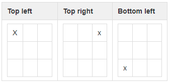

The algorithm splits up the platform into areas:
Depending on the direction parameter, only one field is selected at first:

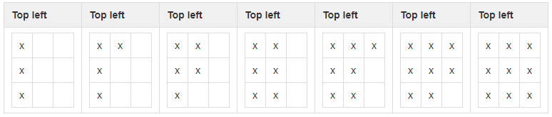

Geometry that is completely covered by this region is printed first. Now a new cell is added to the selection:
New geometry may be printed as well. This process continues until all regions are accounted for.
Build order visualization
Small blocks Big block (All geometry fits into one block)

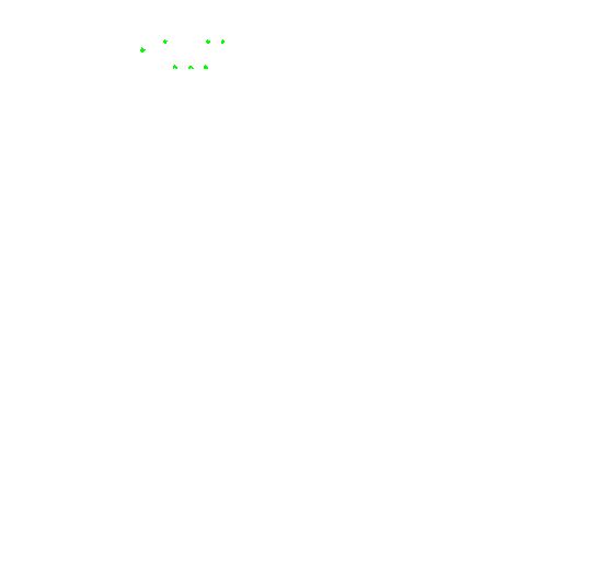

Later, at the postprocessing step, the toolpath geometry is queried using a bsPolylineIterator. Each bsHatchBlock instance will be one bsPolyline instance and it won't be possible to split up toolpaths any further. In some cases, it might be useful to operate on each line instead of each bsHatchBlock instance (which may contain a lot of lines). A parameter (Hatch block split-up) can be used to switch between these toolpath representations. An advantage of that splitting is that every geometry element can be reorganized later on. The disadvantage is that no regional or pattern specific dependency between all these lines is preserved and the reorganization may lead to unwanted jumps between areas that were logically grouped before.
Grouped blocks example Non-grouped example

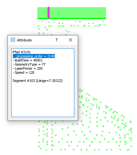

At this point we retrieve tagged toolpaths at a user defined granularity. Now the toolpath elements have to be sorted. Each element already has a default sort value, which is called _processing_order. It is an attribute that can also be seen at the toolpath preview:
By manipulating these attributes, it is possible to change the toolpath processing order using Postprocessing/postprocessing.js:

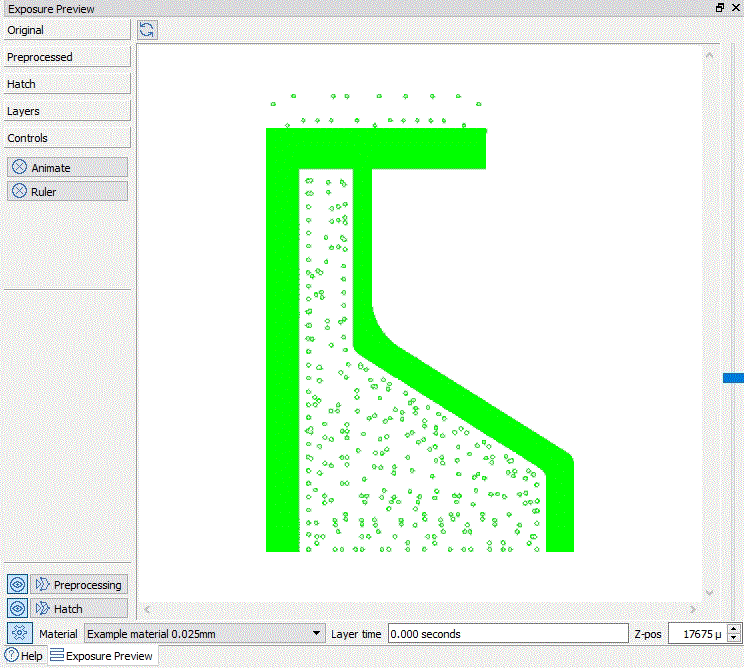

The sorting result can be visualized using the animation option of the exposure preview widget:
