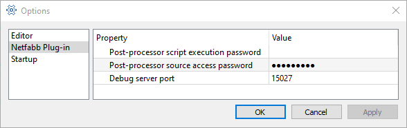

Plugin options
Post-processor script execution password A password to protect an exported EBPA from being executed in a target application without authorization
Post-processor source access password A password to protect an exported EBPA from being reopened in ATU without authorization, protecting the source code
Debug server port Network communication port used by ATU to interact with script execution while debugging.

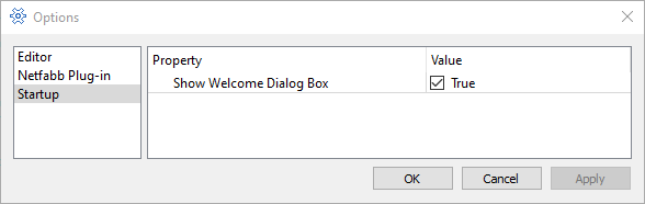

Editor options
Show welcome dialog box On application start a dialog opens to offer quick access to recently used projects
