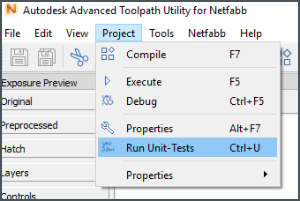

Starting unit tests
The development environment offers these methods for starting unit tests.
By simply pressing the button or menu entry.

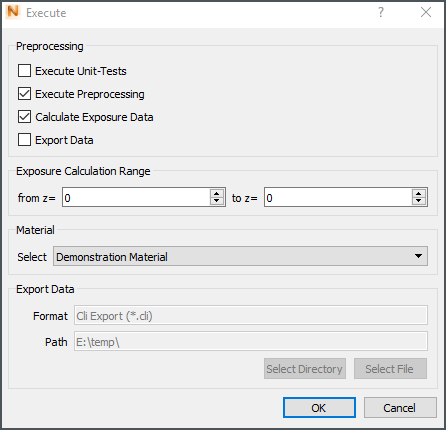

By activating the unit test feature at the buildstyle execution.

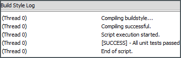

The test result is displayed in both the command interface and in the Build Style Log window.
