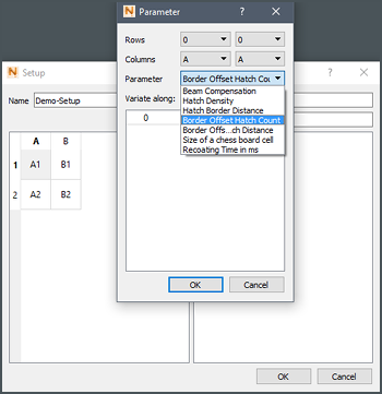

Parameters
Buildstyle parameters are defined in a function called declareParameters. Every parameter has to be part of a parameter group and can store a unique string value and a description. Note that parameter values can be read out everywhere in the buildstyle scripts, but it isn’t possible to change parameter values within the scripts.
Parameter values can only be set by a parent process before buildstyles are executed. Every part of the platform setup in the Export Test Build dialog, for example, can be processes with a different set of buildstyle parameters.
Parameter values can have one of four different types:
