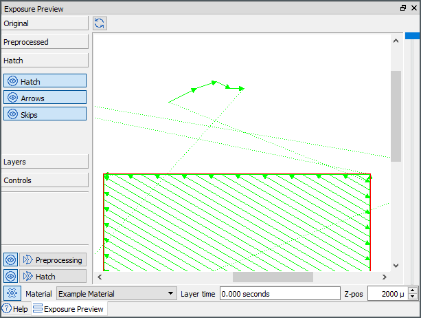

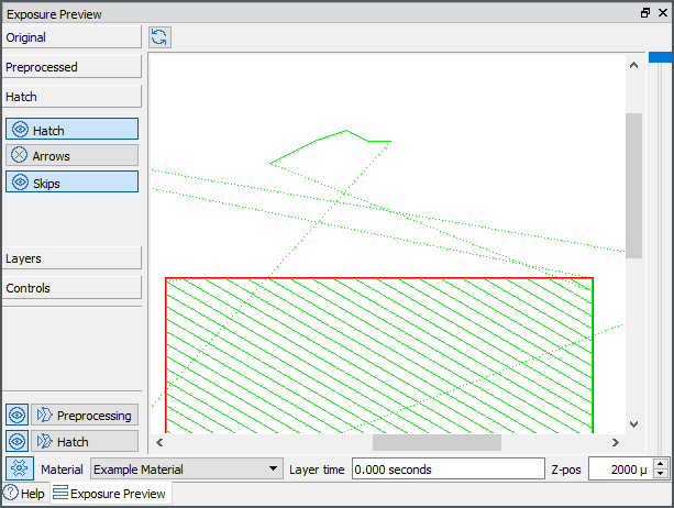

While printing a layer, the additive printing machine will follow the toolpath from a start to an end point. As soon as the layer contains more than one area, the machine has to stop operation, jump to a new position and start operating again. This operation is called a skip. The exposure preview widget is able to show all skips, if desired. The following picture shows skips as dotted lines and a look at the open path below shows, that a skip is needed to reach the beginning of the segment and again to get away from it.
Depending on the layer's geometry complexity, an intelligent order for the toolpath from the first to the last geometry object seems to be a good idea, but at the moment it is not possible to see the direction of the toolpath at all. The machine may start at the left or at the right side of the path above and the rectangle below may be processed before or after the open path.

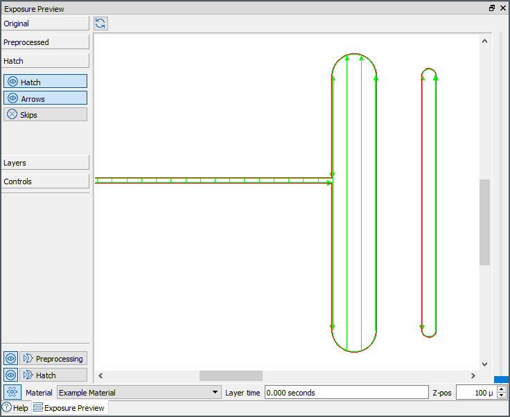

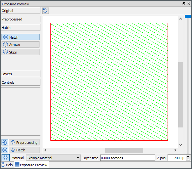

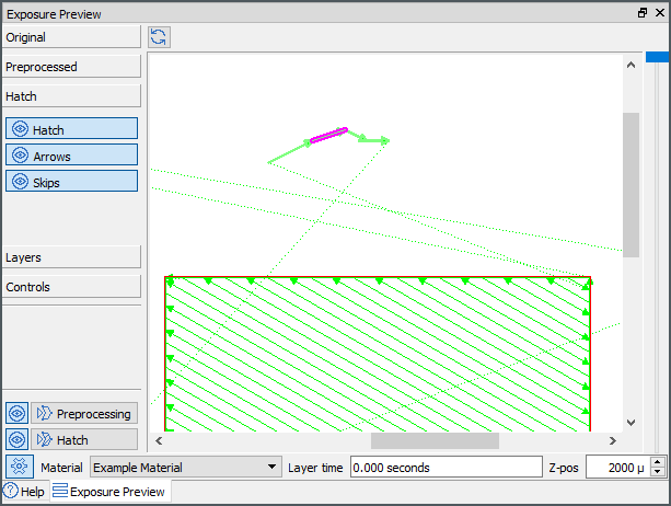

That is why the exposure preview offers to show toolpath directions. Use the Arrows option to enable toolpath directions.
Now imagine, that a machine has to change parameters while following a toolpath. At certain positions the laser power or the speed values have to be in or decreased.
For that reason, the toolpath structure allows to add attributes to toolpath segments. A segment has to be chosen and a rightclick shows a popup menu, that offers an attribute information dialog.

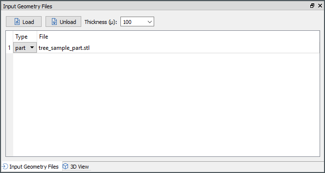

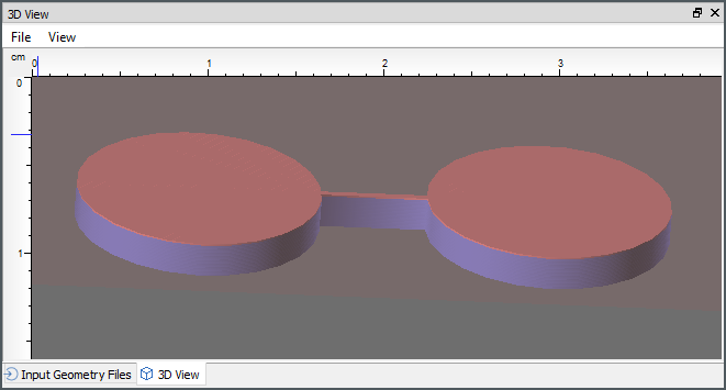

For a start, use the Advanced Toolpath Utility to open the first toolpath creation example buildstyle at C:\ProgramData\Autodesk\ATU\ATU-Examples\tutorial-projects\toolpathing\01_Toolpath-Creation\.
Now, open the Input Geometry Files widget and add the tree_sample_part.stl file as a part to the project. The layer thickness should be 100 micrometers. It can be found ZIP-compressed at C:\ProgramData\Autodesk\ATU\ATU-Examples\Geometry files\.

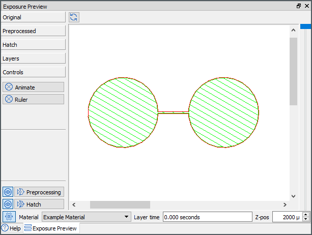

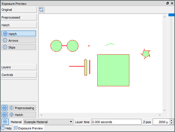

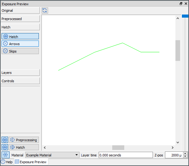

Hit Compile and check, if you can see geometry and toolpath objects at the exposure preview widget.

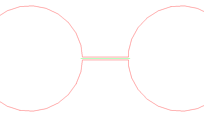

A toolpath for opened polylines is created by simply adding the polyline as hatch geometry to the final hatch object.
function createPolylineToolpath(polyline, geometryType, toolpath)
  polyline.polylineToHatch(toolpath);

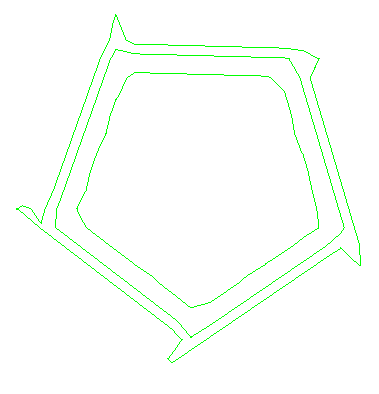

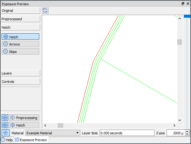

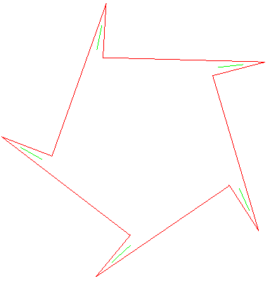

The first important part is the laser beam compensation. Instead of using the island border as a toolpath, which would make the part bigger as expected, a new, smaller island is created as an offset of the original island. This smaller island is added to the hatch container as toolpath.
var beamCompensatedIsland = new ISLAND.bsIsland();
island.createOffset(beamCompensatedIsland, -0.025);
beamCompensatedIsland.borderToHatch(toolpath);

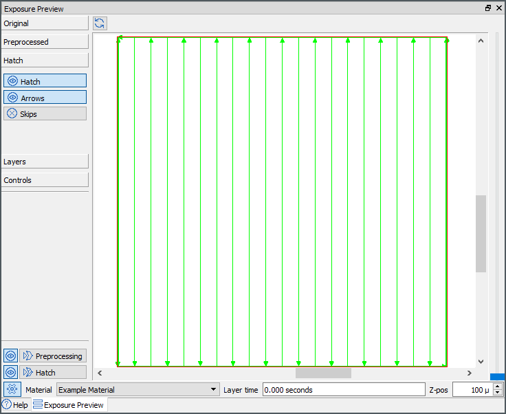

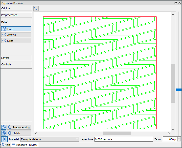

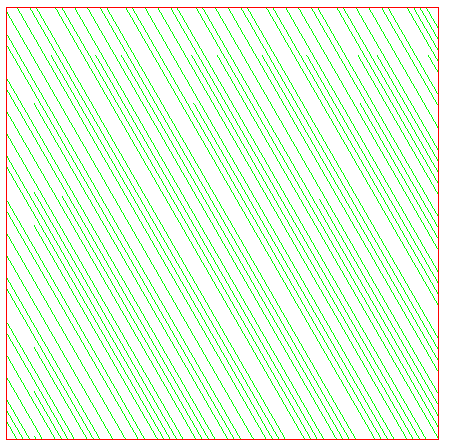

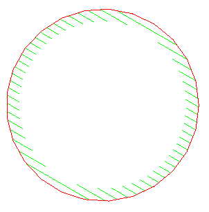

The inner part of the object is filled using a hatch pattern:
Building the object with such a hatch pattern only, would result in a bad object hull, because the stripe pattern may become apparent at the object's hull. Two other offsets, next to the beam compensation offset are used to create a good quality hull.
/* Creates another one, that is again 25 micrometers
   smaller than the first one. This will make the hull
   more solid */
var beamCompensatedIsland2 = new ISLAND.bsIsland();
  createOffset(beamCompensatedIsland2, -0.025);
beamCompensatedIsland2.borderToHatch(toolpath);
/* Creates in "inner" island, that will be used to create
   the internal object structure */
var innerIsland = new ISLAND.bsIsland();
  createOffset(innerIsland, -0.025);
innerIsland.borderToHatch(toolpath);
After all, the inner hatch pattern is generated.
/* Creates the hatch pattern for the inner island */
var tempHatch = new HATCH.bsHatch();
innerIsland.hatch(tempHatch, 1.0, 60, HATCH.nHatchFlagAlternating);
toolpath.moveDataFrom(tempHatch);
A new, temporary hatch container has to be created, because the hatch function deletes existing hatch geometry from the result hatch container.
The hatch pattern is created with a density of 1.0 and an angle of 60 degrees.
Later, the generated hatch data is moved to the result hatch container.

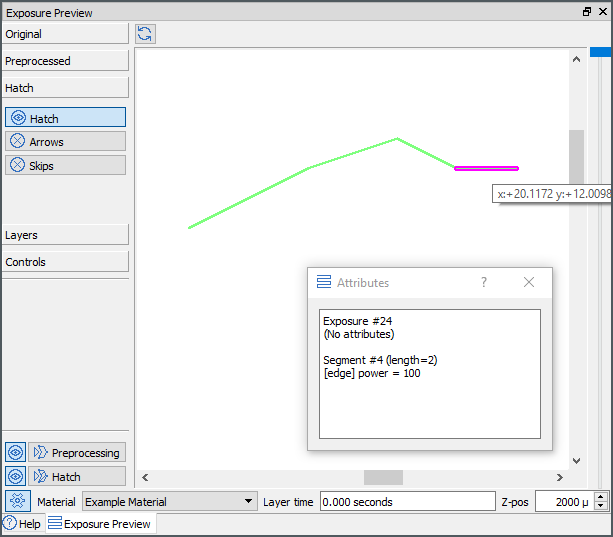

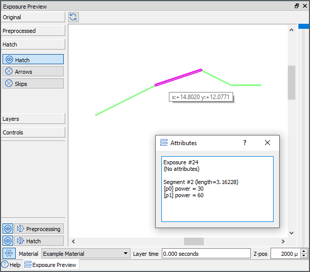

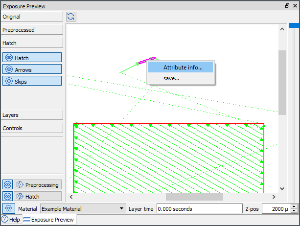

Toolpath attributes are added for opened and closed polylines. The following code box shows the original version of the createPolylineToolpath function.
The createPolylineToolpath before adding attributes:
  polyline.polylineToHatch(tempHatch);
The createPolylineToolpath after adding attributes:
Instead of writing the hatch geometry directly to the overall toolpath hatch object, a temporary hatch object is used now. This temporary object is moved to the overall hatch object at the end.
This was changed, because now the temporary hatch object does not contain any toolpath geometry from previous toolpath calculations.
An iterator is used to step through all generated bsHatchBlock objects (In this case there is one bsHatchBlock object available).
For every hatch block, power attributes are set for the first three points and the fourth segment of the toolpath geometry.
  var hatchBlockIt = tempHatch.getHatchBlockIterator();
  do
    if( hatchBlockIt.isValid() )
      var block = hatchBlockIt.get();
      block.setPointAttributeInt(0,'power', 50, false);
      block.setPointAttributeInt(1,'power', 30, false);
      block.setPointAttributeInt(2,'power', 60, false);
      block.setPointAttributeInt(3,'power', 100, true);
  }while(hatchBlockIt.next());
For closed polylines, toolpath attributes are added to every hatch block.

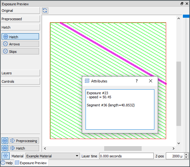

The temporary hatch object contains geometry from the hatch pattern generation only. An iterator steps through all bsHatchBlocks and adds a speed parameter to all pattern geometry segments.
  do
      block.setAttributeReal('speed', 50.45);
  return toolpath;

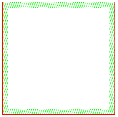

The following picture shows the open polyline structure of the buildstyle project.
Using the right mouse button action shows the popup menu. The "attribute info" menu entry opens a property dialog box. Moving the mouse across the line segments, while the attribute information dialog is still open, shows the attributes for different points and segments.
A closer look at the attribute information dialog box shows the difference between point and edge (segment) attributes.

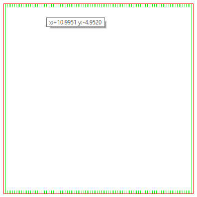

The next picture shows the rectangular geometry from the buildstyle:
The attribute information dialog for the inner toolpath shows the speed attribute at the exposure (#23), instead of showing it at the segment. The example above has added attributes to the segment itself. Here it was added to the whole hatch block.

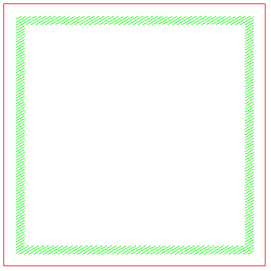

The following example adds bridge sections (areas, that are too thin for creating the desired hatching) to the hatch object.
/* Bridging of two seperate areas */
function getNarrowBridge(island, toolpath)
  var offsetedIsland = new ISLAND.bsIsland();
  island.createOffset(offsetedIsland, -0.3);
  island.createNarrowBridgePolylines(tempHatch,-0.3);
  // offsetedIsland.borderToHatch(toolpath);

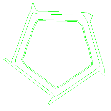

The following example adds sections with pointed edges (edge regions, that are too thin for the hatch pattern) to the hatch object.
/* Pointing edges */
function getNarrowAppendix(island, toolpath)
  island.createNarrowAppendixPolylines(tempHatch,-0.3, 1.0);
  //offsetedIsland.borderToHatch(toolpath);

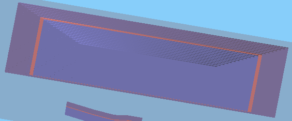

The following example adds upskin areas to the hatch object.
/* Upskin areas */
function getSkinAreas(island, toolpath)
  var skin   = new ISLAND.bsIsland();
  var noSkin = new ISLAND.bsIsland();
  island.splitSkin(skin,noSkin, true);
  skin.hatch(tempHatch, 0.3, 60, HATCH.nHatchFlagAlternating);
  //noSkin.borderToHatch(toolpath);
The following example adds overhang sections to the hatch object.
/* Overhang (simple) */
function getOverhangAreas(island, toolpath)
  var normal   = new ISLAND.bsIsland();
  var overhang = new ISLAND.bsIsland();
  island.splitOverhang(normal,overhang);
  //normal.borderToHatch(toolpath);
  overhang.hatch(tempHatch, 0.3, 180, HATCH.nHatchFlagAlternating);

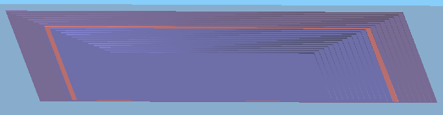

The following example calculates overhangs across multiple layers with a defined downskin angle (this example uses 3 layers and an angle of 20 degrees).
/* Overhang (multiple layers and downskin angle are considered) */
function getMultipleLayerOverhangAreas(island, toolpath)
  var volume            = new ISLAND.bsIsland();
  var overhangNoOverlap = new ISLAND.bsIsland();
  island.splitMultiLayerOverhang(20, 0.0, 3, volume, overhang, overhangNoOverlap);
  overhang.hatch(tempHatch, 0.3, 60, HATCH.nHatchFlagAlternating);

The createStripeRegions example demonstrates stripe generation. A more advanced demonstration of stripes can be found at the programming examples section. The chessboard demonstration buildstyle uses the stripes to generate a chess board pattern.
It uses the createStripes function to split up islands into a region of several stripes. The result is an bsIsland object containing several islands (the stripes).
function createStripeRegions(innerIsland, toolpath)
  var angle = 0;
  /* create stripes */
  var resultStripes = new ISLAND.bsIsland();
  innerIsland.createStripes(resultStripes,
                            2.0,
                            1.0,
                            -0.25,
                            100.0,
                            15);
The takeOutDiscreteArea function can be used to extract each stripe (curIsland) one by one from the stripe results island object.
  var curIsland = new ISLAND.bsIsland();
  while( resultStripes.takeOutDiscreteArea(curIsland) )
Each stripe will have a border and is filled with geometry from a hatch pattern. The hatch pattern's angle is alternated between 0 and 90 degrees.
    if( angle == 90 ){
      angle = 0;
    else{
      angle = 90;
    curIsland.borderToHatch(toolpath);
    curIsland.hatch(tempHatch, 1.0, angle,
      HATCH.nHatchFlagFixedOrigin | HATCH.nHatchFlagAlternating);
    curIsland.makeEmpty();
Examine Buildstyle Calculation Results
For the flexDensityAndAlternateHatching example the following hatch function has to be used in createIslandToolpath.
flexDensityAndAlternateHatching(innerIsland, toolpath);
//fixedHatchPatternOrigin(innerIsland, toolpath);
//createStripeRegions(innerIsland, toolpath);
The exposure preview widget can be used to get a similar view of the part below. The "hatch" and the "arrows" option have to be turned on.
The direction of the inner hatch pattern is alternating. It starts downwards, goes upwards and then downwards again. Change the flexDensityAndAlternateHatching function by removing the "alternating" option and the direction will change to upwards only.
function flexDensityAndAlternateHatching(innerIsland, toolpath)
  var angle = 0;
  innerIsland.hatch(tempHatch, 1.0, angle,
    HATCH.nHatchFlagFlexDensity);
Removing the "density" option will rearrange the internal hatch pattern just a bit.
Now use the exposure preview to show the rectangle.
The z-pos box (at the lower right of the exposure preview panel) can be used to switch between layers. Using it to view the layers above creates the impression, that the hatch patterns lines are moving. The rectangle is getting bigger layer by layer and the hatch pattern is oriented by the rectangle itself. That is why the pattern's lines are aligned on different positions for each layer.

For the last example change the code at createIslandToolpath to this.
//flexDensityAndAlternateHatching(innerIsland, toolpath);
A striped pattern should appear with alternating hatch angles.

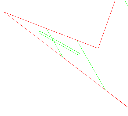

At the modifyNarrowAppendixPaths function pointing edge areas are detected first.
function modifyNarrowAppendixPaths(island, toolpath)
  /* Find edge areas */
Found geometry data is then written to a bsPathSet object.
 /* Create bsPathSet and add hatch geometry */
  var hatchPaths = new PATH_SET.bsPathSet();
  hatchPaths.addHatches(tempHatch);
  process.print('Number of paths: [' + hatchPaths.getPathCount() + ' ]');
An offset is calculated for each path.
  /* Process a simple modification (create an offset) */
  hatchPaths.createOffset(0.025);
The previously generated hatch geometry is cleared and the offset paths are added to the hatch object. After all, the hatch data is added to the overall hatch object.
  /* Delete existing */
  tempHatch.clear();
  tempHatch.addPaths(hatchPaths);
  /* Apply hatches */
This buildstyle creates output to the buildstyle log widget.
The first thing to examine is the amount of hatch blocks before and after splitting them according to their power values.
Processing island no 0
No of hatch blocks before segmenting 1
No of hatch blocks after segmenting 6
Processing island no 1
Processing island no 2
No of hatch blocks after segmenting 4
Processing island no 3
No of hatch blocks after segmenting 3
Processing island no 4
No of hatch blocks before segmenting 0
No of hatch blocks after segmenting 0
Processing island no 5
No of hatch blocks after segmenting 11
Then, the hatch block order is displayed by showing the power values before and after sorting.
Unsorted hatch block list
Hatch block power val 10
Hatch block power val 20
Hatch block power val 30
Hatch block power val 40
Hatch block power val 50
Hatch block power val 60
Hatch block power val 70
Hatch block power val 80
Hatch block power val 90
Hatch block power val 100
Hatch block power val 110
Sorted hatch block list
This buildstyle invites to play with different parameters.
Here are two examples:
Example 1 Example 2
var outerHullIndex = 0;
var innerHullIndex = 1;
var outerHullSkip = 1;
var innerHullSkip = 2;
var coreSkip = 3;
var surfaceOffset = 0.0;
var coreSkip = 3;
var surfaceOffset = -0.2;
The second hull starts at layer 3 (300 micrometers).
The core starts at layer 8 (800 micrometers).
The second hull is generated every second layer.
The core is generated every third layer.
The second hull starts at layer 4 (400 micrometers).
The core starts at layer 10 (1000 micrometers).
A negative hull offset of 0.2 is added
At 800 micrometers the first and the second hull are generated.
The third, closed polyline in the middle is the inner loop (the hole) of the second hull.
The core is skipped. It is rendered every third layer.
At 1000 micrometers the first and the second hull are generated.
The first hull is now an offset region inside the part's border island
800 micrometers
1000 micrometers
At 1200 micrometers the first and the second hull as well as the core are generated.
The fourth, closed polyline is the offset core border.
1200 micrometers
1200 micrometers
