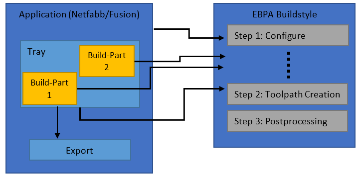

About postprocessing
The postprocessing step takes place after toolpaths have been calculated for all parts on the tray. The toolpath creation step is done for each part individually and happens multi-threaded layer by layer. Therefore, it is not possible to achieve certain tasks in this step, e.g. sorting the toolpaths on a layer from left to right. It would only be possible to sort the toolpaths of one part from left to right.
In postprocessing the whole tray is available with all calculated toolpaths. This makes it possible to optimize the toolpaths on each layer, e.g. to reduce traveling time in between parts or to assign toolpaths to individual lasers.
