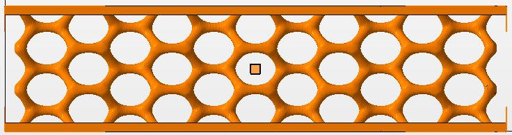

To Export the Part to Netfabb
The steps below repair any issues with the mesh and export the lattice component to Netfabb.
  1. From the toolbar menu, click Export to Netfabb > Component.
  2. Make sure the Automatic Part Repair check box is enabled.
  3. In the menu to the right of the check box, choose the Extended Repair option.
  4. Click Add Parts.
