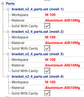

  1. In the Properties Panel, click the Simulation tab > Parts, and assign the values for Workspace and Material to each of the meshes, as shown below.
