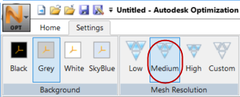

  1. Along the top of the Optimization Utility Toolbar, click the Settings tab > Mesh Resolution > Medium.

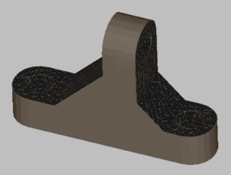

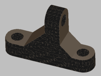

    On the Properties Panel, note that the file contains four separate meshes. We will set the properties for each one on its Part tree.
  3. For meshes 1, 2, and 4, set the following properties (any bright color is fine):

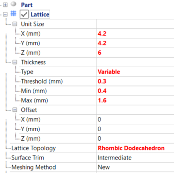

  4. For mesh 3, set the Type to Lattice, and the View to Shaded Wireframe, then set up lattice properties as follows:

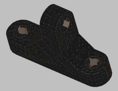

  6. In the Properties Panel, click Solid - Region1 and assign it to the three bolt holes by pressing Ctrl+Left Mouse Button and selecting a few polygons on the inside of each hole.
  7. In the Toolbar, Selection panel, set the Tolerance level to 25 and click Flood Fill.
    The surface region is applied to the entire inner surface of each hole.

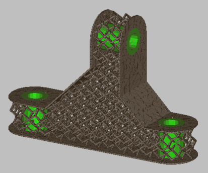

  8. In a similar process assign Skin - Region2 to the bottom, top, and flat sides adjacent to the bolt holes, as shown below.
  9. Assign Hollow - Region3 to the remaining curved surface.
  10. In the Toolbar, Actions panel, click Create Component. The result should appear as shown below.
