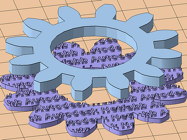

The plate type can be Solid, meaning a continuous, featureless plate, or be a grid of either Hexagonal or Rectangular pattern. If the build room contains another part, you can also select Custom mesh: This applies the shadow area as a stencil to that mesh and applies the result to the source part. (This necessarily ignores the value of Baseplate height as the custom mesh naturally has its own height.)

A spur gear with a baseplate stenciled from a custom mesh
