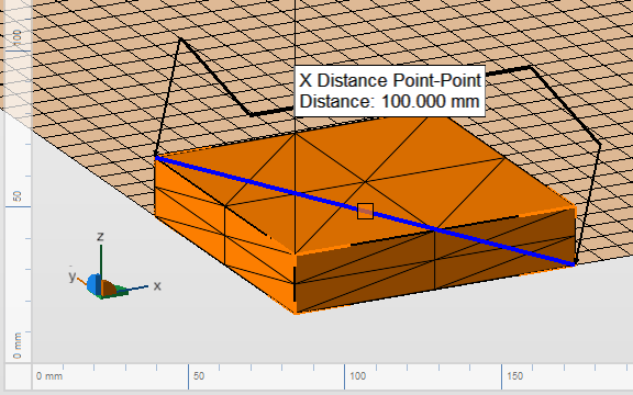

Distance measurement options
X, Y, and Z
With the toggles provide here, one for each of the cardinal axis, you select which component in 3D space to display in the label for the next measurement. This can also be changed individually for any existing measurements using the context menu of a measurement label in the display.
A diagonal measurement set to display the X component only.
