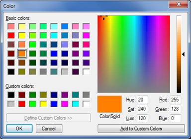

Color dialog box
Several options are provided for picking a color:
The chosen color appears below the spectrum, in the Color|Solid field, along with the associated HSL and RGB values. The change of color is confirmed when you click OK.
To save a custom color for later use
  1. In the Color dialog, on the lower left, click a custom color block.
  2. Adjust it using the spectrum, brightness, HSL, or RGB controls.
  3. On the bottom right, click Add to Custom Colors.
    The new color appears in the block you initially selected.
